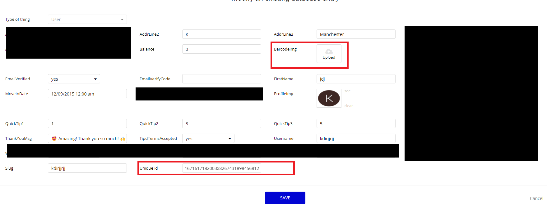

  1. I can’t find a way to save the QR Code against my user in my database (but it is being uploaded to File Manager)
  2. The logo quality in the QR Code
Re point 1
I can get the QR Code to render (although the sizing / responsiveness is off as you’ve mentioned above) but cannot get it to save to the DB.
Ideally, I’d like to it work in the same way as we had with the previous version of the plugin, where we have the QR Code Element shown but only 1 pixel in size (so effectively hidden from the user), let it finish generating and then provide a URL which I can store against the Barcodeimg field for this user in my database. I have an Image element on screen which displays conditionally, once the BarcodeImg field is populated and we can size accordingly without needing to worry about the responsiveness issue above.
As you can see below, on page load if we do not have a QR Code saved for the current user, we will generate one using the new version of the plugin
Then when the QR Code has finished generating, we make a change to the current user to set the “Barcodeimg” field to be the newly generated QR Code (like we did with the old version)
However, it isn’t saving to the DB and I don’t know why. It is however saving against the user in file manager but then I don’t know how to call use this in the app
File manager
Database
In Summary
Please can you advise on the workflow required to generate the QR Code with a logo and store it in the database against a user so that: we only have to generate it once, we can store the image against the user and then show the QR Code in an image element for the current user?

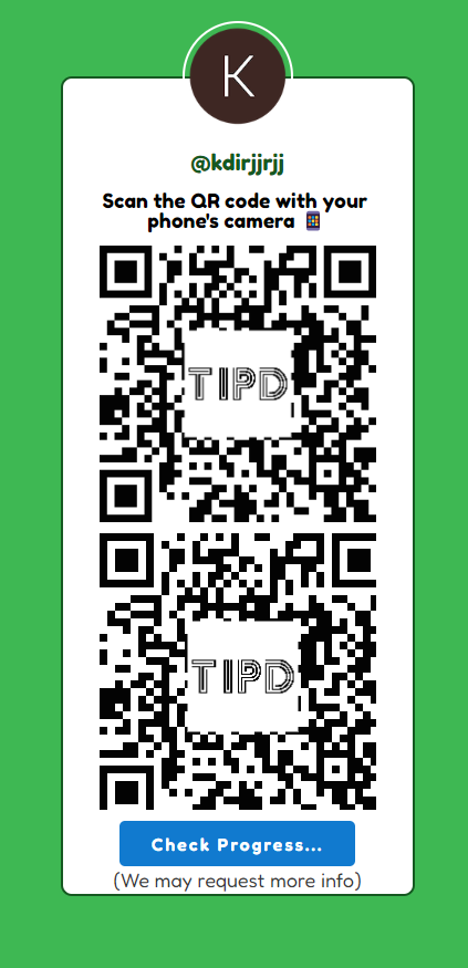

In the old version, I think we could size the element on screen to be 1x1 pixels to make it almost invisible to users but in the element settings we could specify the size of QR code image generated, separate from the element. However, in this version I can’t seem to be able to do that, so the size of the element on screen appears to dictate the size of the QR Code generated. So if I set it to 1x1 pixels, the image generated is tiny and unusable. If I make it larger, the user can see it. I’ve also tried hiding the element completely but then the plugin doesn’t run.
In each of the screenshots below, the top image is just an image element. The bottom image is the QRCodeWithLogo Element. You can see I need to make it larger than the image size in order to get the required quality but obviously, I’d rather not show QRCodeWithLogo Element at all.
(The reason for not generating / rendering each time is to improve speed and make sure I have a local copy (to bubble) of the image which may also be printed out, etc).
In Summary: Do you have any advice please to meet the requirement of specifying the generated QR Code size, without needing to show the element of the same size?
QRCodeWithLogo Element at 500 x 500
QRCodeWithLogo Element at 250x250
Thanks again!!!
Hi @chris.anderson:
Good catch. Just pushed v.2.1.0. See below screenshot. Note that nothing will render to the screen if you override the size, so you can make the element by 1 px by 1 px if you want to.
@nicholasrbarrow well that works brilliantly!!! Amazing, well done!!! Kudos to you for this plugin, the clear instructions and the quick turnaround. And for making it free! Thanks very much!!! :smiley:
