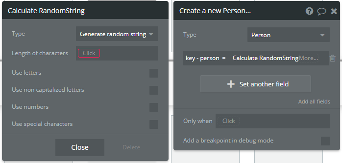

thanks Andersan but my question was specifically if it will generate a unique id because I am using it to assign to an identifier. I think there is a possibility that a random number can again be generated, so do you reckon that this would not be a suitable number generator to assign to a unique identifier column?
Hi there, @kmeenakshi26… when saving a field to the db, there is a Calculate formula option that can have a type of Generate random string.
As you can see in the screenshot, you can specify the number of characters to include in the string, and you can select other parameters, too. Now, I’m guessing there is always a chance that no matter how many characters the string has and what other parameters it includes, the system could generate the same string more than once. That being said, the chances would likely be so small (depending on how you configure the string generator) that maybe it would work for you? Just a thought… hope it helps.
Best…
Mike
One option to prevent two objects from being assigned the same ID would be checking whether another another object already has the same ID.
If there is another object with that ID, you could generate another one and assign it to the object.
Mike is right that with enough characters (e.g. 12 non-case sensitive alphanumeric characters) you should not run into duplicate IDs. With 12 alphanumeric characters (0-9 and A-Z) there are over a billion possible IDs that could be generated.
Thanks Mike, I may actually take that chance. If I were to search for an ID in the entire DB before assigning, that will be a hit on system performance. so I may do away with that thought. I have implemented it as you have shown here. Thanks again
Thanks Andersan, If I were to search for an ID in the entire DB before assigning, that will be a hit on system performance so I am not planning to do that. I may just take the chance of an odd error being thrown in case it has a duplicate ID
