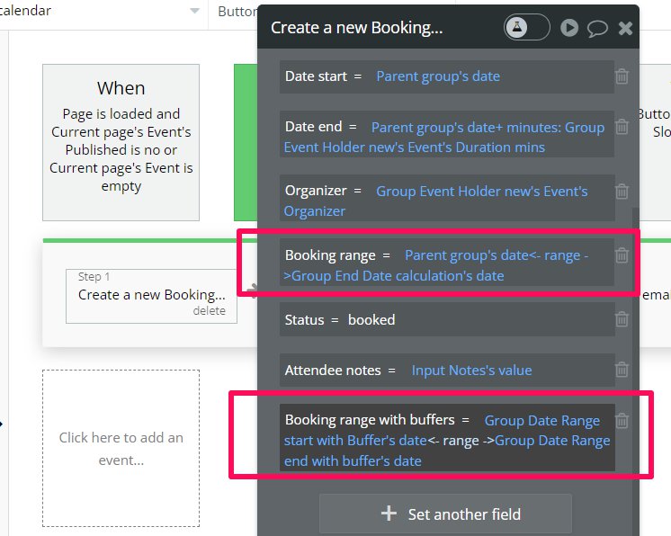

Here are some important steps to do this:
  1. Include a Booked time range with Buffer on the Data table like below:
  2. When a Booking is made, you will want to save both the original booking time range and the time range with the buffer (gives you more flexibility showing Bookings later on a calendar). The example is an older app setup that uses Groups to hold the Date/Times with the Buffer, but with parentheses this may be able to be calculated in the formulas now (not sure)
  3. When loading Booked Times into the GetAvailableTimes element, make sure you use the Booking Range with Buffer so that the extra hour is blocked out of available times:
These examples were screenshotted from my Top Calendar Template that includes Buffer logic
