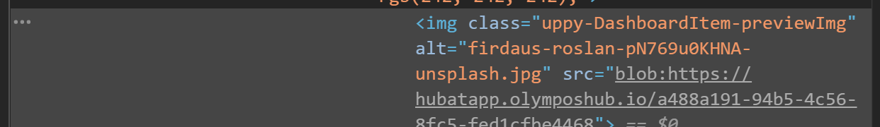

Hello @jon2! Thanks for the awesome plugin :slight_smile:
Is it possibile to retrieve and save the preview thumbnail image to a thing, or find a way to be able to do this? It could be useful to be used as a light image for galleries etc.
Thanks
/Edit: I noticed that’s maybe possible to expose a state with “previewIMG”. Inspecting the browser:
Uppy thumbnail generator

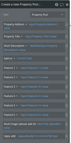

Hello.
Totally new to Bubble. Seeking a very easy to use multi file uploader, i discovered Uppy.
Image upload works just fine, but i can’t seem to be able to set up the right workflow to get the images to upload to the Bubble Database.
My scenario is using Uppy in a form with various inputs where Uppy serves as the input for multiple images.
Can anyone help with the right workflow to make the uploaded images upload and show up in the database?
Below is what my current workflow looks like:
Screenshot 2020-07-08 at 20.56.08
Looking forward to your replies.
Thanks in advance
