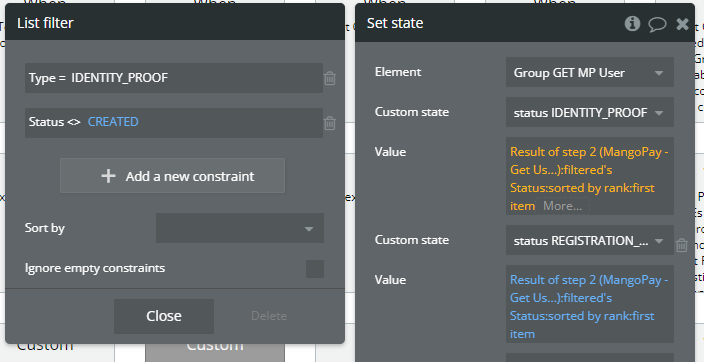

Here are some images of the two times this happened :

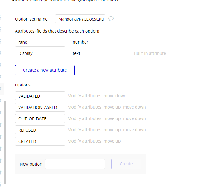

In both cases I use the following Option set :
First case : Not able to use the different opperator “<>”
Second case : Not able to use an = operator

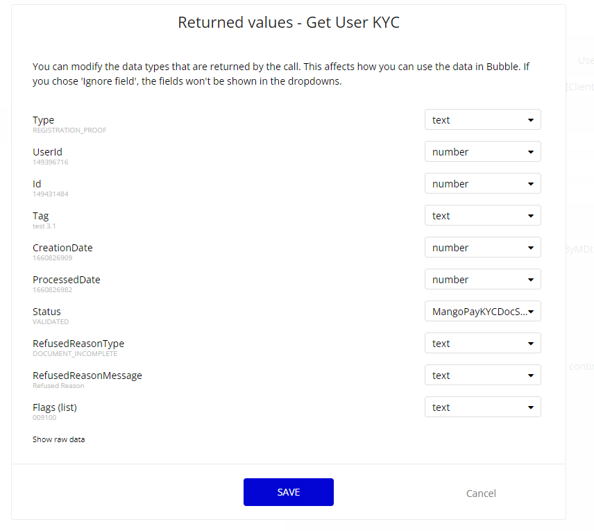

Can you share how you mapped the fields’ types when the API was initialized?
It’s mapped as the option set
My impression is that when I use a direct reference “Result of step XXX”, it takes the raw response before it was converted to the Option Set type, even though in the editor it recognize as an option set.
Maybe try mapping it as text and then in your filter say it equals an option’s display instead. If that fixes the issue then I would say report as a bug.
