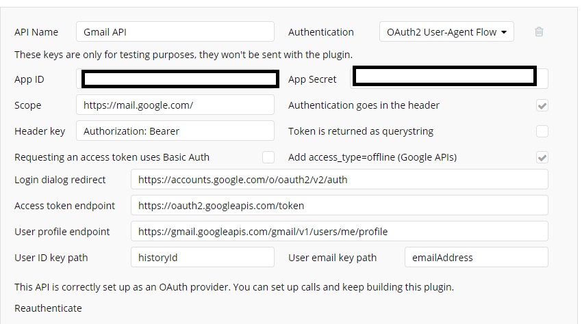

Hi antoine
I’m having roadblocks setting up Oauth 2 for GMAIL API… I will greatly appreciate if you can give detailed insight on how you were able to get this done …thanks
