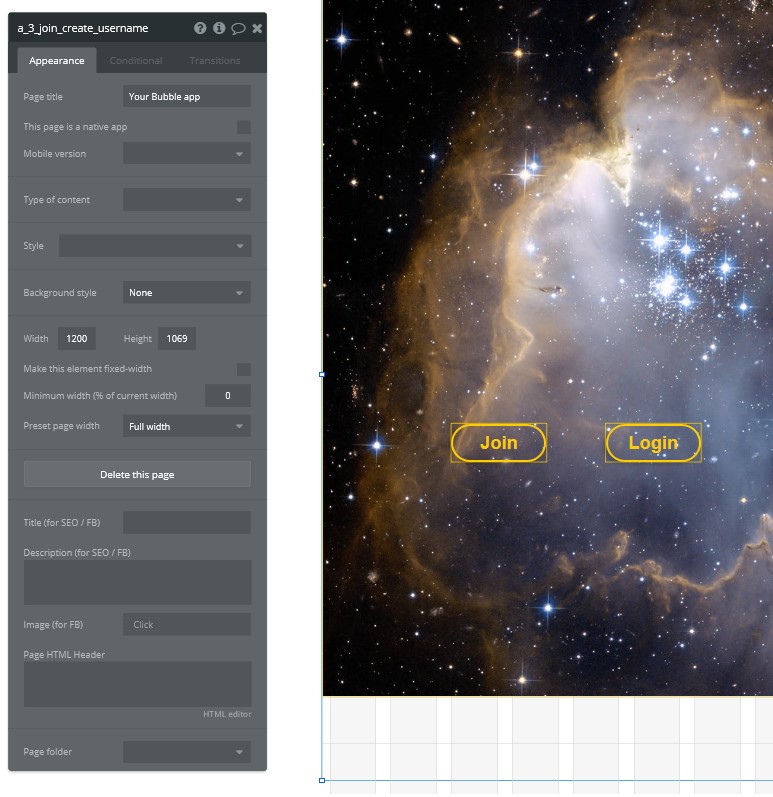

Here’s my page settings

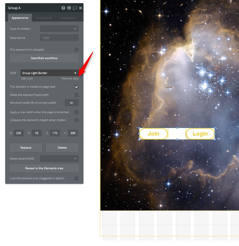

And here’s what happens when I group them … give me 1 sec …

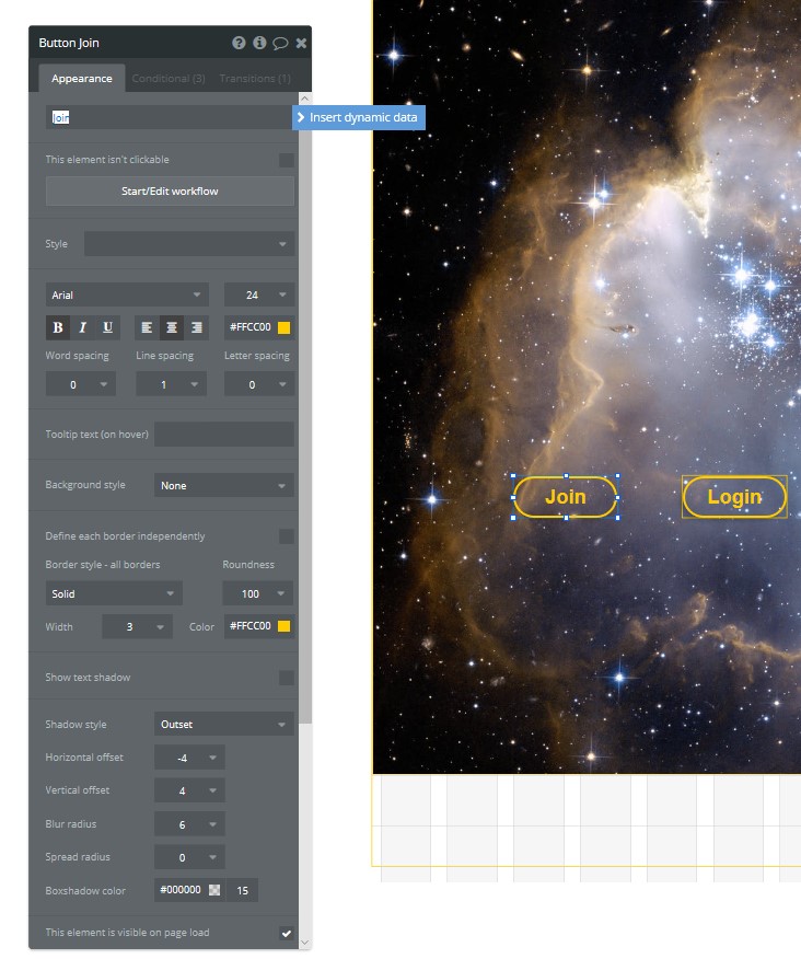

Here’s my settings before I grouped them …

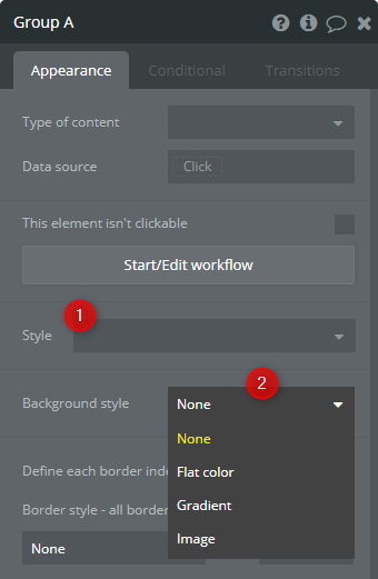

In the Group Properties, there is a Style dropdown. You need to remove the style (there’s a “Remove style”) link.

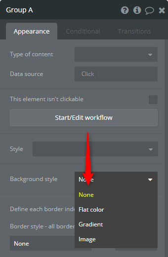

Once you’ve done this, you will need to set the Background style dropdown value to “none”.
Got it now!! You rock! Thank you very much :slight_smile:
