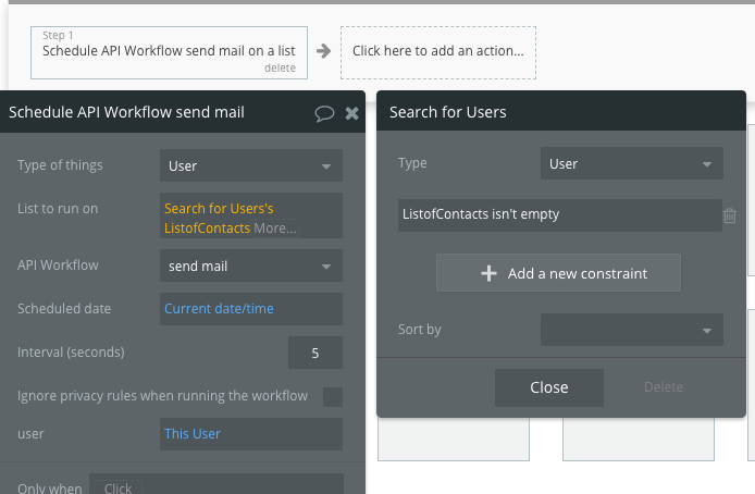

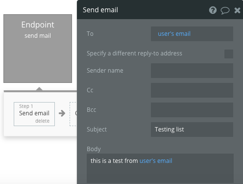

@andrew6 - I did a quick mockup. The data structure is as follows. Under Data Type User I have a Data Field called “ListOfUsers” which is a list of type User. Each of the app’s Users would have this data field filled with 100(s) of email addresses. Then in the workflow below, do the scheduled API flow. Do you have something similarly setup in your app?
Then the API endpoint is below. I had two Users each with a list of two end-users. When i ran this, I got 4 emails, one to each to the end-users. Hope this helps.
NOTE: In my data structure, I had “ListOfUsers” setup as Users - I think you want it set up as “text” since I think you’re just capturing emails and not actually setting up 100’s of Users in your app.

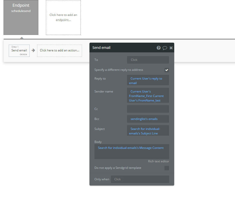

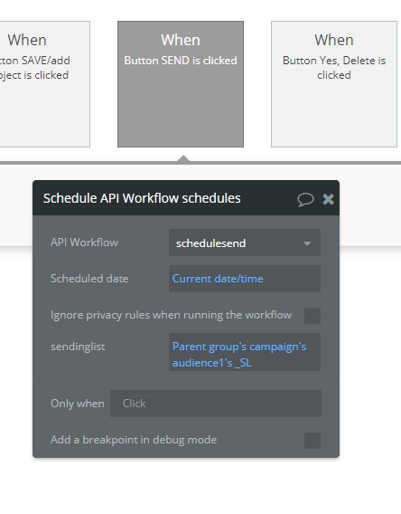

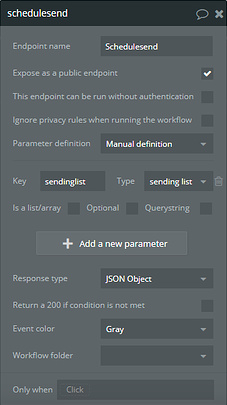

@nikolai thanks for taking time to look at this. The two models I’ve tried are pictured below. The goal, is to just send individual messages to these contacts, 1 after another… (like 15 seconds out)… , but that is not how it is working.
Current setup - (which requires something to be in the “TO” field, or it won’t send: This causes all emails in the list to be sent as BCC, at the same time. Not idea, but serviceable.
Other option Works, but it just sends all the emails to the to field, at the same time, and everyone can see everyone else in the list.
Goal to send to the list, as the “to” field, individual emails.
The bottom option (“Other option”) is the one you want to work with because it’s handling a List of things which is appropriate for your list of emails. Bubble will iterate on the list so if there’s 100 emails, it’ll call the API endpoint 100 times.
Referring to pic below, it appears that for “sendinglist” you’re actually sending a list? But with this scheduled API workflow, you want to send the endpoint a single “text” item. So you probably want to replace “sendinglist” with something like “email” and where it shows “Parent group’s campaign’s audience…” you’ll have result from the “List to run on” which will be of type text and the value will be an email address.
In the API endpoint, a few things: 1) Click the “Optional” button for “sendlist” key. This will allow the workflow to pass info the the API endpoint but not require it (leaving it blank and not sending data from the workflow will cause an error). I’m saying this because I don’t think you’ll need “sendlist” but don’t want you to delete it in case it is needed.
2) Add another Key such as “email” . It’ll be the same type sent from the Workflow (probably also “email”)
3) In the API endpoint workflow, put “email” in the “To” field.
Pretty tough doing this via email and not seeing your data structure but hopefully this makes sense and gets you a little closer to figuring it out.
