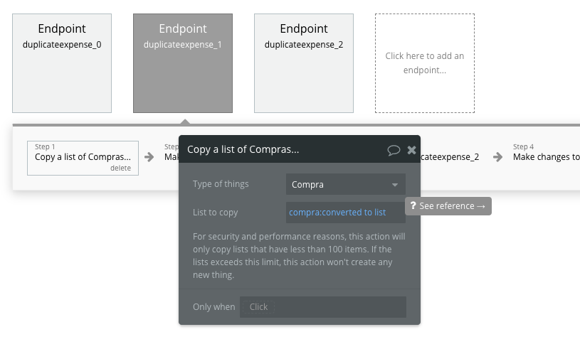

Can you share screenshot of your settings in both Bubble in Integromat?
In Bubble with a loop, you should not reach more than 20-30% of capacity.
Sure, here it is:

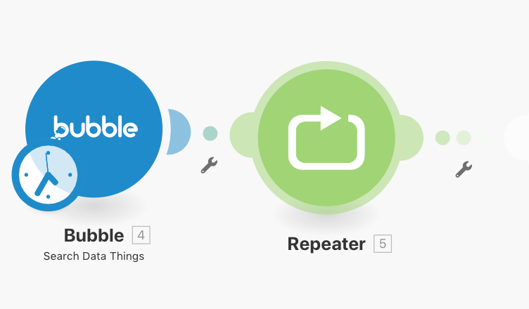

About Integromat, I´ve just done this:
I don´t even know how to configure the Integromat Repeater and I´ve been trying and looking for documentation for hours.

So I’m pretty sure that what take a lot of capacity in your Bubble WF is the Copy a list of thing + make change to a list of thing. Instead, you should create a loop to copy it one by one, just like the repeater in Integromat will do.
The repeater will just run what you have after it the number of time you provide. Not sure what data contain the Search data thing, but if this contain # of time to run (3 to 24) just dynamically put this into the repeater. Then let initial value to 1. This will increase for each step. So you cna use this number to calculate the next month date. So after the repeater you will probably have Create a thing in Bubble. This will repeat the number of time set in Repeater

So you mean that instead of copying a list of compras like the image below, “create a new thing” and set the values such as the master invoice (the one that is going to be copied).
But there is one thing to consider, the first newly copied invoice should have the previous invoice date + 1,2 or whatever the user selected.
