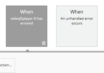

Is there an exposed state for a network error for the video? Perhaps I’m missing this, its a different condition than the video file not being available on page load. It throws up an error message inside the player and I’m wondering if this error condition could be exposed. Thanks

For the second comment, there’s not currently an exposed state for network error (or video load error) but you do have an event called “videoJSplayer has errored” that might catch video loading errors, I’ll have a play with it. There’s the Bubble error catching event also which may help. If neither of those do the trick, I’ll add an exposed state in which gets populated when a video fails to load for whatever reason (or a make that videoJSplayer has errored event trigger).
There is also an event called “when metadata is available” which fires when the video is ready to play.

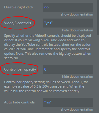

The VideoJS controls option now has an additional bit of text added to the documentation part since when you use this, it also hides the big play button on first launch.
The control opacity setting of 0 never used to work, now when it’s set to 0, the control bar is removed instead so you no longer get the mouse over click icon still appear.

The ‘on error’ event does trigger when a media fails to load (for whatever reason).
The different MEDIA error types that you get are as follows:
0 string MEDIA_ERR_CUSTOM
1 string MEDIA_ERR_ABORTED
2 string MEDIA_ERR_NETWORK
3 string MEDIA_ERR_DECODE
4 string MEDIA_ERR_SRC_NOT_SUPPORTED
5 string MEDIA_ERR_ENCRYPTED
Each one of those has a custom description assigned to it. When the error event is triggered, you now get the description put into a new exposed state called Media error description.

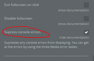

I’ve added a field option to disable any loading console errors like so.
And created the three states below which will always get populated on any loading errors etc.
  • Media error code
  • Media error type
  • Media error description

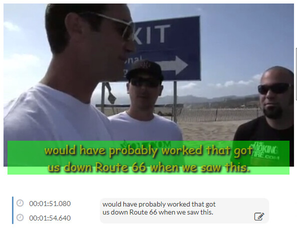

As requested, a couple of new options.

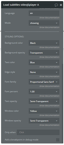

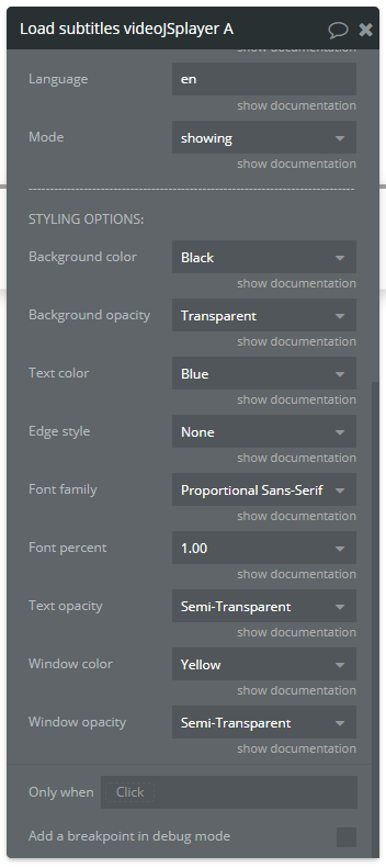

The Load subtitles action now features all possible styling options available for subtitle tracks.
The action looks like this, each option has a set of dropdown values.

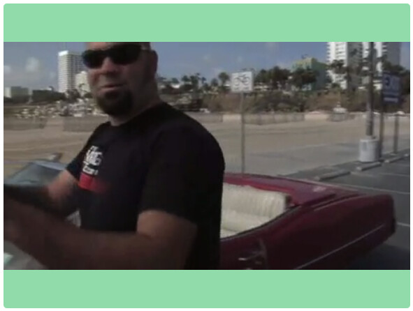

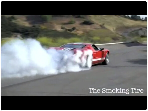

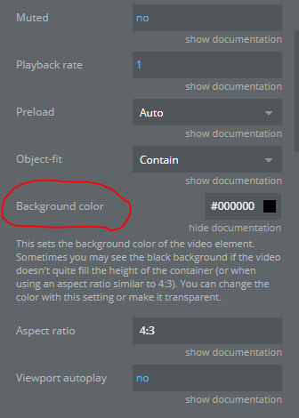

And the background color of the video element can now be changed to any color or it can be made transparent. This might be useful depending on the aspect ratio in use as sometimes if the video’s height doesn’t quite fit the container proportionally to the width then you see the black lines at the top and bottom.
Before
After
And after again but made transparent
The option is here:
