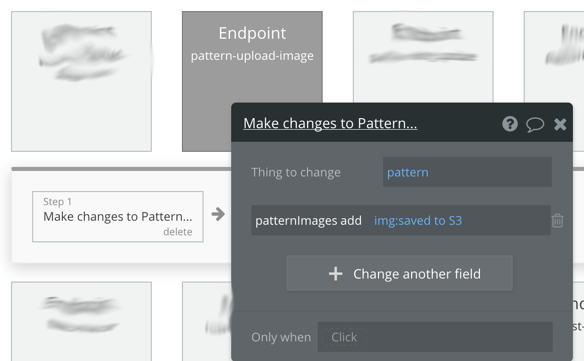

Hey @anon20158934 - the way I did it was to create an API Workflow like this:
Where Pattern is a Bubble “thing” in our app. It has a field patternImages that is a list of images.
Inside the workflow I set it to save to S3 (using patternImages add because it’s a list):
And finally, I called the API from another script using JavaScript (you could just do a plain PostMan request, or whatever)…

The important part here is the pattern and img parameters that match the workflow parameters. Also the format for the image is parameter is{filename: <whatever name you want>, contents: <the image Base64 data>}.
