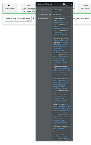

I’ve been grappling with an issue for several days now and haven’t been able to resolve it. I’m working with four API calls to generate emails, utilizing an API connector and Postmark. Everything was functioning seamlessly until Postmark updated their API to reject improperly formatted JSON.
Despite extensive testing and debugging with tools like RequestBin, JSONLint, and others, my calls appear correct, yet Postmark consistently rejects my POST requests. The errors are type 422 from Postmark, indicating a “Workflow error - The service Postmark - Diagnostic xylophages (test) just returned an error (HTTP 422). Please consult their documentation to ensure your call is set up properly. Raw error: {“ErrorCode”:403,“Message”:“Received valid, but incompatible JSON input.”}”
Debugging this issue is challenging. When I extract the JSON from the logs and test it on JSONLint, it seems valid. I wonder if the problem could be related to the formatting in Bubble, or if the ‘json safe’ format is not functioning correctly.

For better clarity, I’ve attached five screenshots:
  1. png → Shows the JSON structure.

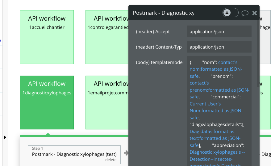

  2. png → Displays an array within the JSON used for email creation. I suspect the problem might stem from here.

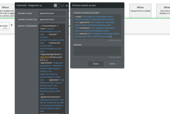

  3. png → Illustrates the ‘selection’ format as text.

1.png ==> the example of the json structure
2.png ==> I have an array on this json to create the email so i put this screen, I suspect, the issue can come from this so as per your informaiton
3.png ==> the format ast text of “selection”

What does it look like you’re passing through in your Bubble logs?
There can potentially be something you’re passing through that violates their rules causing the 422 error
I have this (see attached) and if you test the json it works on jsonlint :

Je suis quasi persuadé que le probleme vient du formatage de mon array et que c’est ça qu’il n’accepte pas car je viens de réussir pour les autres call à faire fonctionner. Tu as peut être un dernier avis la dessus ??? merci beaucoup @Jici

Tu as la partie format as text de selection?
Screen Shot 2023-11-18 at 04.38.19
voici !
