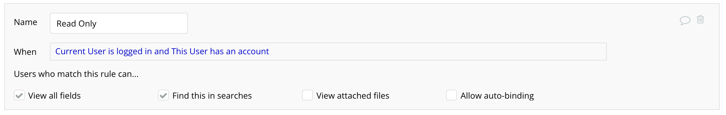

  2. Send a screenshot of your privacy rules

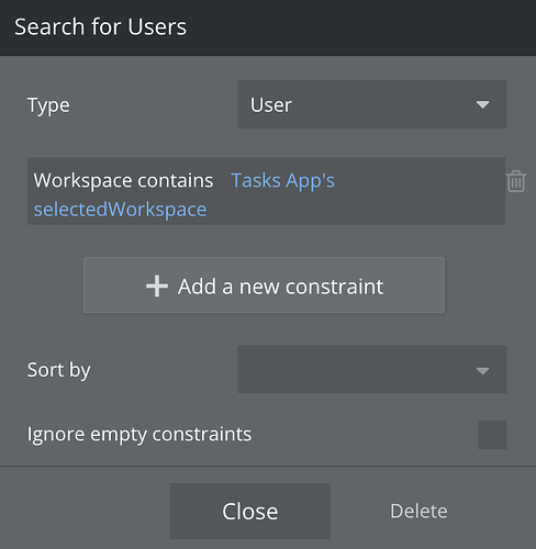

  4. Send a screenshot of the expression you have to display the data

4.
Privacy rules are evaluated on page load - could that be the issue here (if a user is logging in without a page refresh, for example?)
I assume has an account is a yes/no and is yes for the relevant users?
Has an account is built in, I added it trying different things. It used to be only “current user is logged in” and still had the issue.

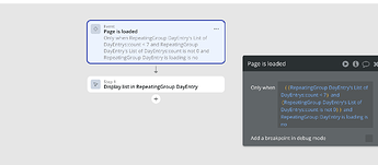

I had something very similar happening to me. I’ll share what I did, it might help you out sort your problem.
So, I had to populate the RG on page load - so every time page loaded I checked if the RG was finished loading (RG is loading is no) AND if the list had the amount of items I expected. In your case you could expect that the RG:count > 0.
If the amount of users is 0 then you trigger the second action: Display list in RG.
This way, I re-assured the page was reloaded with the data correctly populated.
In your case, I see list has to be displayed every time you press the filter button. So, on button click, you could add the step “Display list in RG” with the conditions I previously mentioned to re-populate the users lists in case it fails to fetch a first time.
