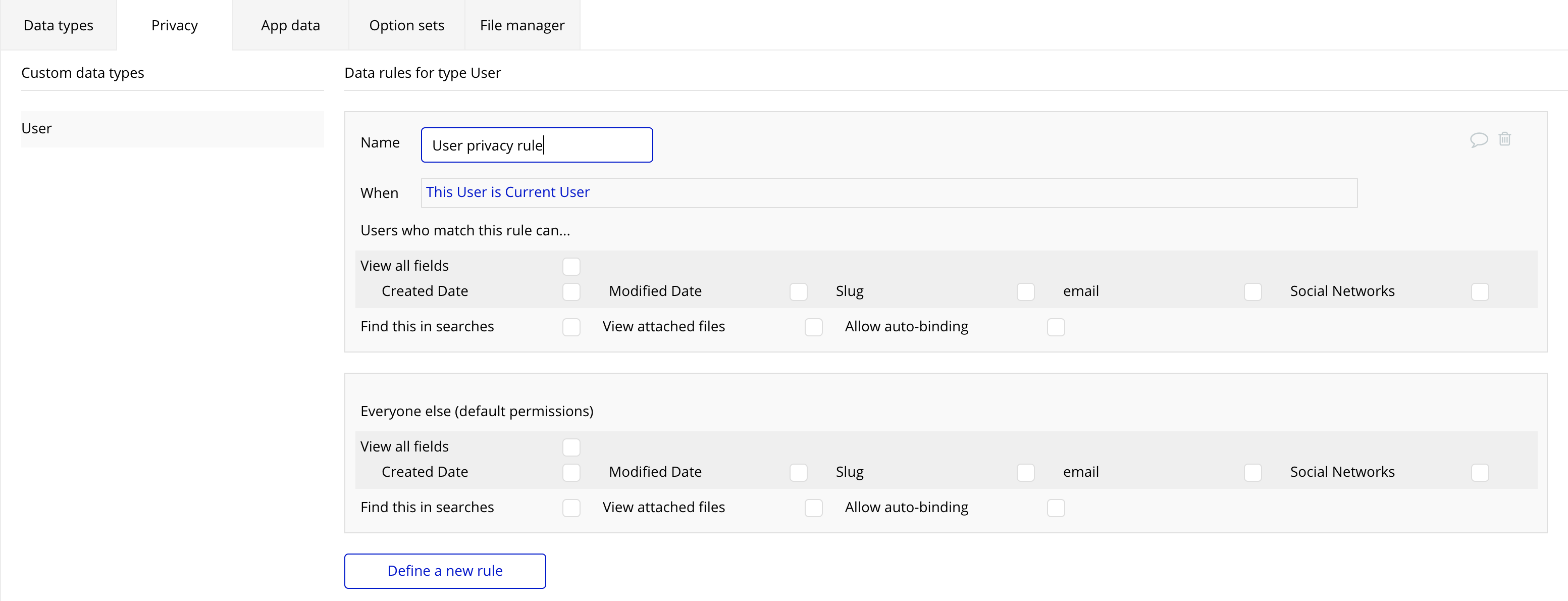

I certainly want to make sure that only I can access my list of users (subscribers). I’m aware that with Bubble’s default settings, a simple script can “discover” my users’ emails, despite not building any feature of my app to show users the other users. How do I make these users private (I’ve attached at the bottom what I think I’m supposed to do, but I have no clue if this is right why it works)? Also, if I do this, will this disturb any of the features of my Stripe subscription?

You would need 2 privacy rules defined.
  1. So the user themselves can view information about themselves
  2. So you can view users
For #1:
You are on the right track with “This User is Current User.” You simply need to make sure you check the “View all fields” box.
For #2:
I’m not sure how your database is set up, but you should create a type called something like isAdmin?. From there, you would only make yourself and anyone else you might want to have that list of users the boolean value of Yes. In this case, your “When” would be Current User isAdmin "is yes."
If it’s just you that needs to be able to view the list of users, you can also do something like this in the “When” value: Current User's email address is __your email__. Just be careful about this in the terms of: make sure that you never delete an account with that email.
Hope this helps and clarifies a bit! :blush:

Just to clarify: your paragraph #1 is what will only allow users to view information stored in the database about themselves? If so, why does this exclude them from viewing all the other users’ email address?
