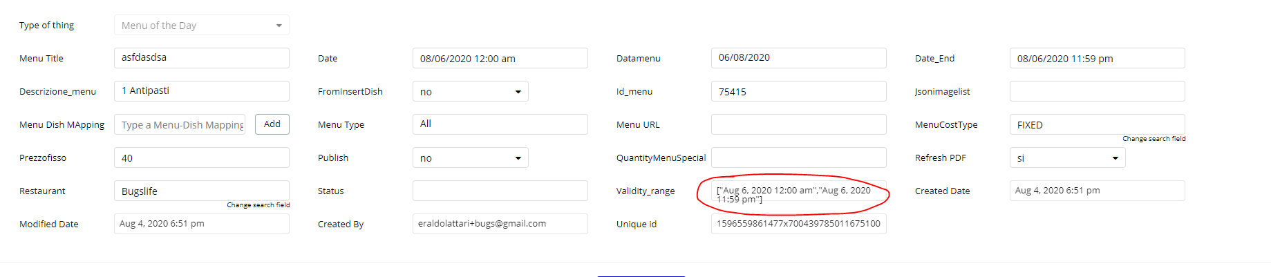

Hello to all guys. I’m trying to put a condition where I set that IF THE CURRENT DATE is NOT included in a field within my database (with a range value) then that element must not be visible. However, I am having difficulty setting the condition. Can you help me?
Basically I should say, if the current date is not in the range (circled in red) then don’t show it.

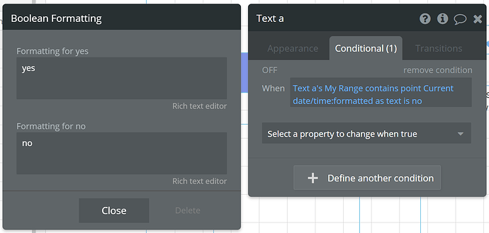

  3. Use a stupid expression hack: Even though you can’t build an expression like some_boolean_expression is "no", you CAN build (and this is incredibly frustrating): some_boolean_expression :formatted as text [you'll get a dialog here] :is "no" … to which you’re now like, “You’ve got to be fucking kidding me. I can’t negate a boolean expression, but I can convert the boolean to text and then do a stringwise comparison to turn the text BACK into a boolean value!? WTELF!?” But it’s true.
:point_up: one of the more ridiculous Bubble expressions you’ve ever been forced to build… but it’s pretty expedient and, in the grand scheme of things, not really any different performance-wise from having a truly boolean expression. But this should offend our sensibilities to no end. (In fact, how is this NOT a bug?)

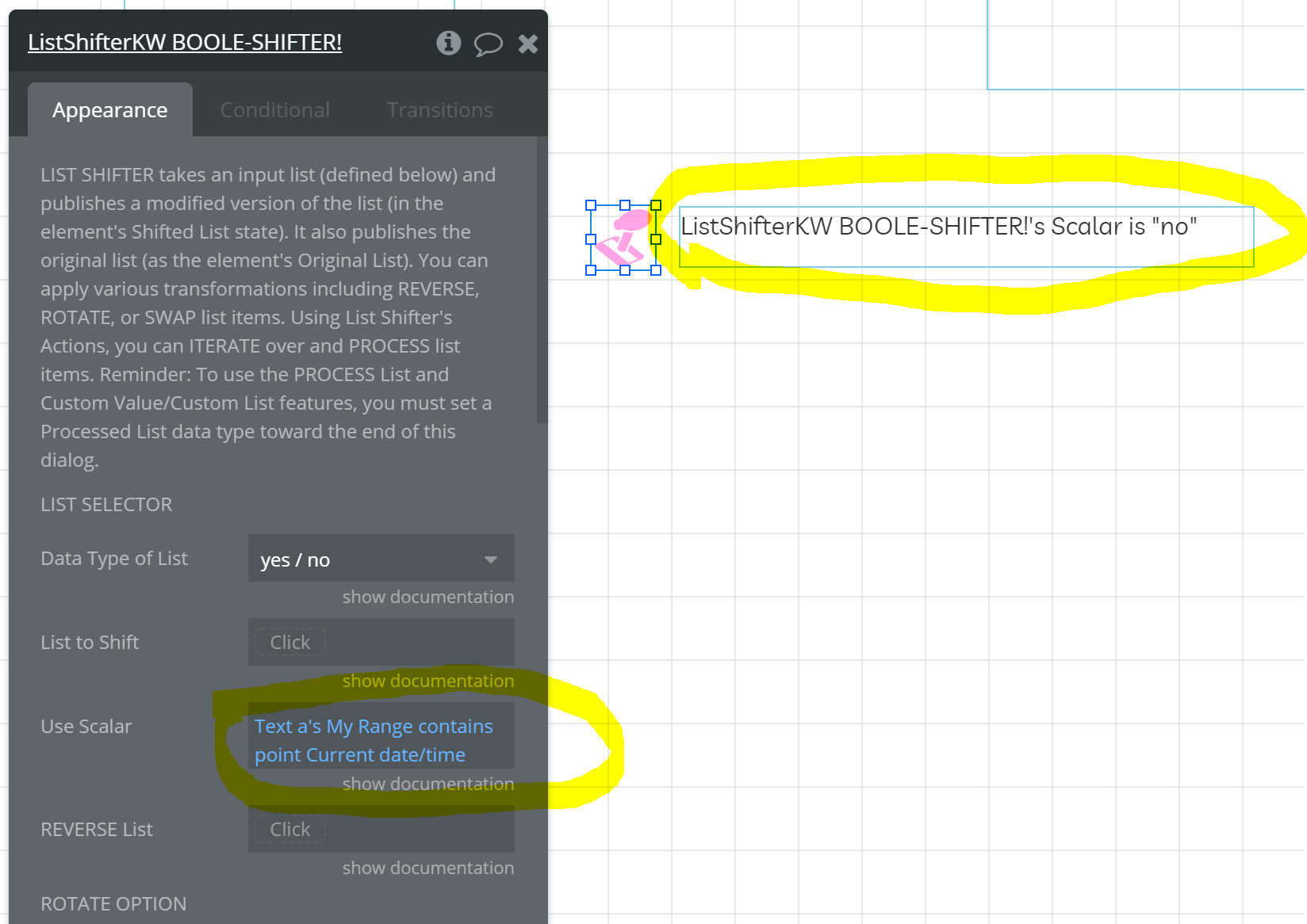

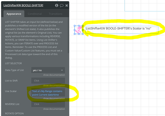

  1. Use some handy plugin like List Shifter – which has a scalar input (that can be of any type, including a boolean) that’s echoed to the plugin’s scalar output whenever the input value changes. You can then read List Shifter’s Scalar output and put :is "no" after it. Like this:
:point_up: This List Shifter just takes a boolean expression (which we put in the “Use Scalar” field), computes it, and passes the result to List Shifter's Scalar output. Any time the value of the expression changes, the value of List Shifter's Scalar output changes (damn near instantaneously). And, since that output is of boolean type, we can write the expression List Shifter's Scalar is no.
This might seem like a “hack” (like #3 is a “hack”), but this is in fact a use case for which List Shifter is designed. There are many times that you want to evaluate some expression and be able to actively react to (or passively consume) changes to that expression and List Shifter gives you this ability.
(In olden days, people would use Input elements that are styled in such a way as to be invisible to do this, but List Shifter is a better way to accomplish the same thing.)
