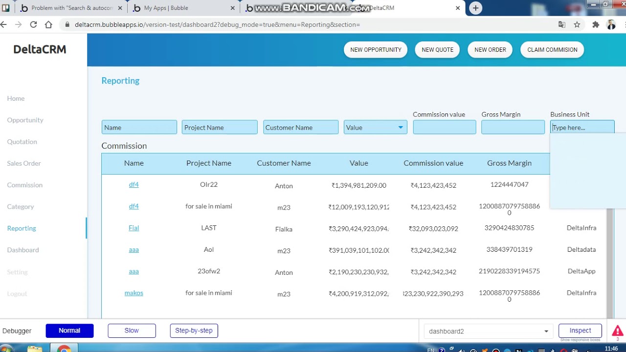

This is my setup, was working if use a data type different of text
Hello, @yorgio1024
Thanks for the screenshot.
First of all, please note that here you should indicate the DataType of the entries you are searching for.
Please note that such DataSource could be confusing for the plugin and Bubble platform itself since it is too complicated. Our plugin works only with the Text entry format, so it means that each entry, you are searching through the DataBase, should be in Text Format.
Please find the screenshots of our settings below:
Can you please let us know in which cases the plugin works on your side?
