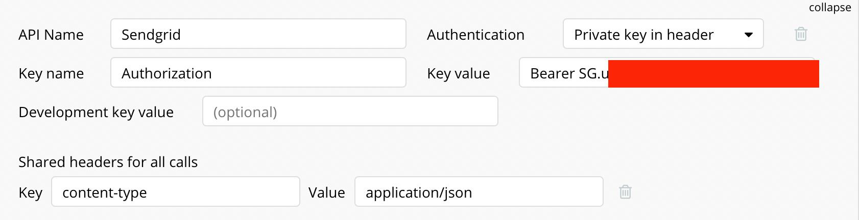

So I went through the API Connector. There I do receive a 202 with a job_id but the user is not added to my list (see in the screenshot)

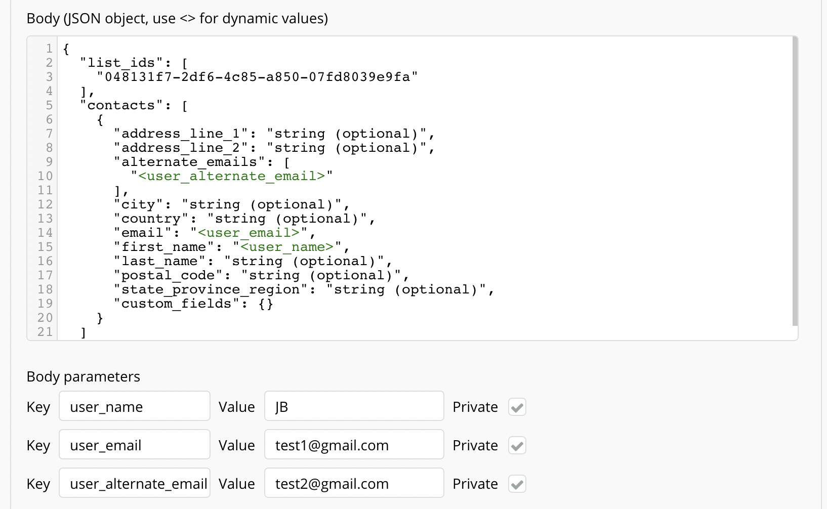

But now I got another problem. I can’t see my variables in the workflows :
My call :
I have another call like this for another API and it works well.
Do you know what is wrong with this ?!
You’ve set them all to ‘Private’ so you can’t access them in workflows.
You need to uncheck the ‘Private’ box so you can set the variables dynamically in your workflow actions.
