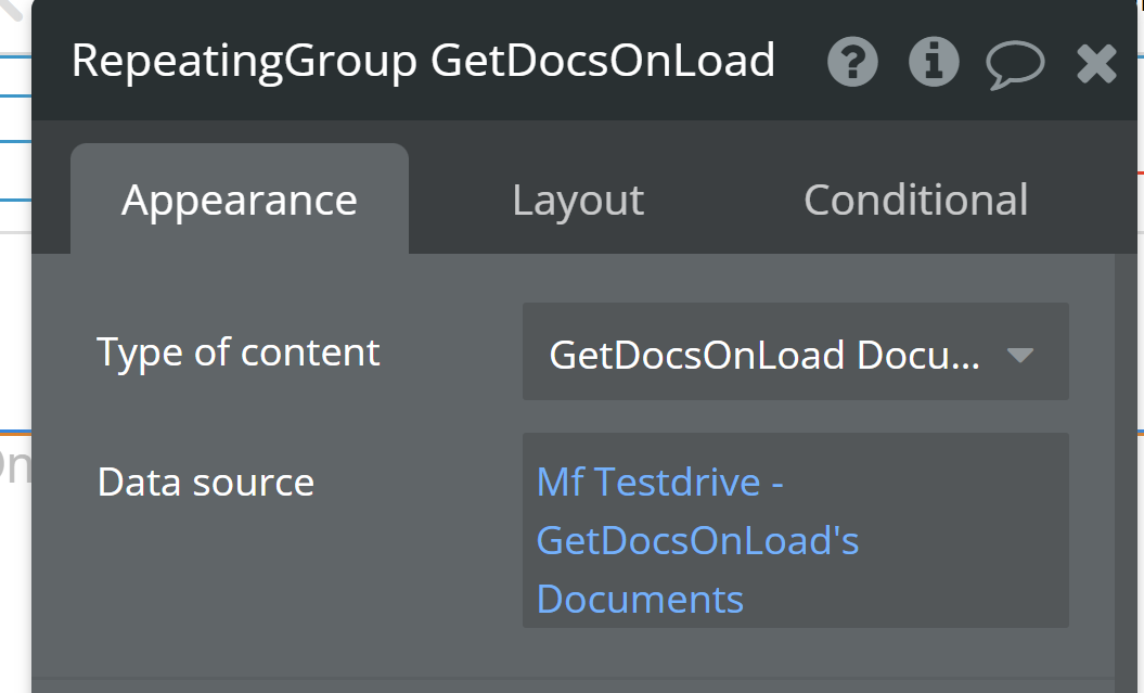

My API-Call is named GetDocsOnLoad and is set to Data.

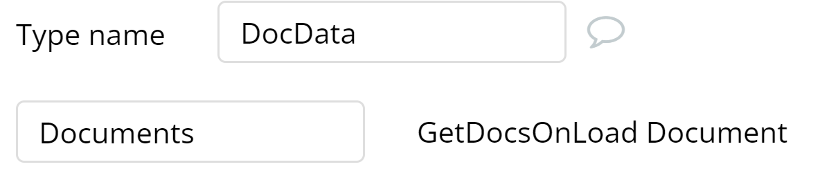

I’ve created a new Datatype with a field “Documents” with the suggested type “GetDocsOnLoad Documents”:
But here’s the issue: how can I achive to save the whole JSON to my database?
As you can see, it is always displayed in red, and nothing seems to help.
I’ve already tried to make an extra field in my “DocData” for each attribute of the JSON-File (Title, Url, Date) or to mark this field as a list, but none of this worked.

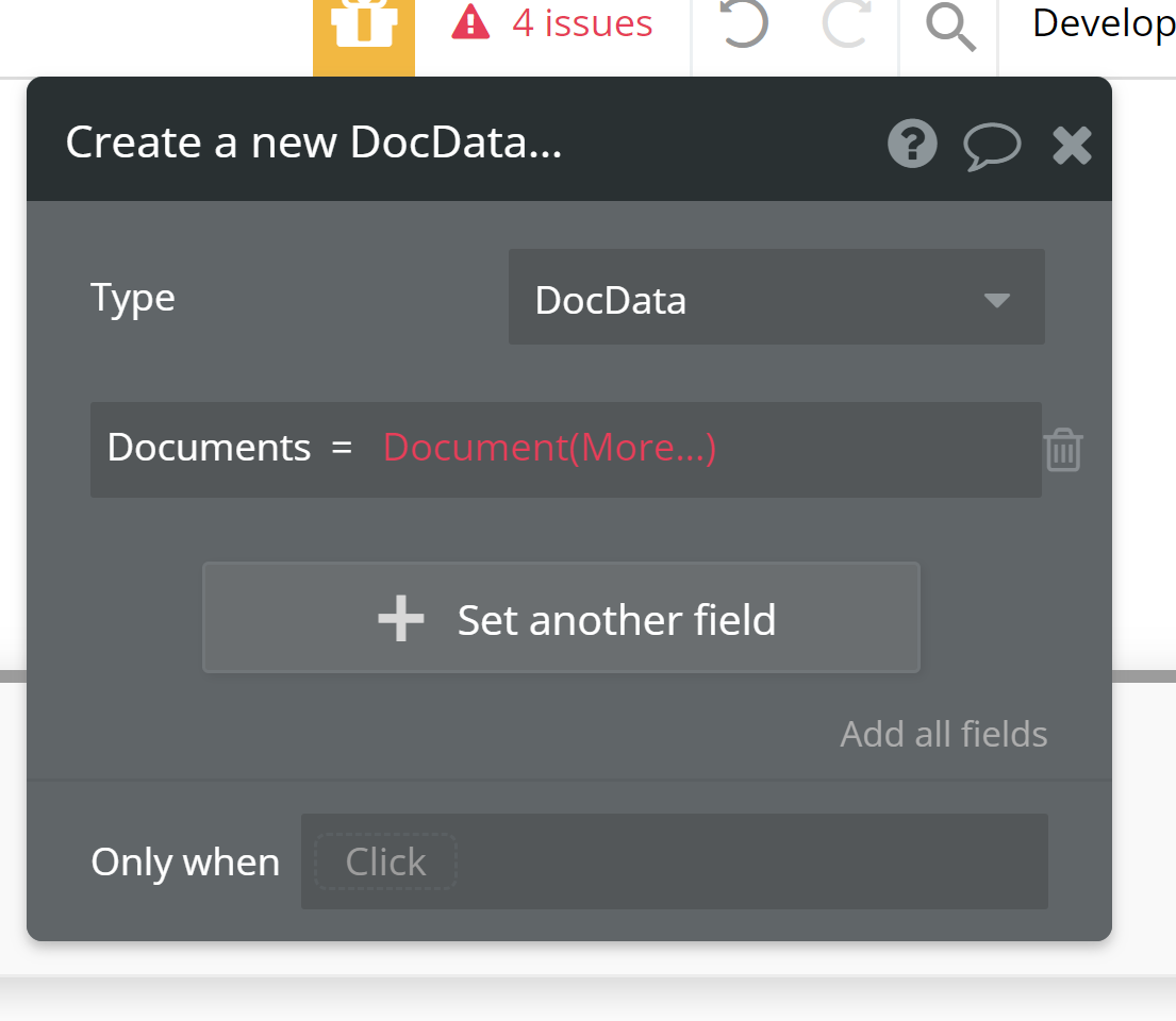

What I think is that you want to save the Data of the JSON (not the json itself) into field of your DB.
The first thing to know is that, when you set API Call to be “Data” type, Bubble will create a “Thing” of the API Call type. You can save this in a field that have the type of API Call directly
IF you need for any reason, save each json object into a different field, you can process the API Call in backend WF and save it in DB by selecting the value you need. Like API Call’s TotalHit’s to a number field.

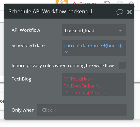

So I want to run this workflow every night automatically.
I know that I have to kick this workflow off initially in the frontend and recall the same workflow in the workflow itself.
Therefore, I want to “Get Data From an External API” which should call my GetDocsOnLoad-Method.
But here, I cannot manage to make it work (unlike in the frontend where i can display the data on demand in the data source).

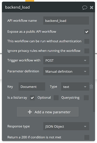

Which kind of field is TechBlog? Actually, the GetDocsOnLoadDocuments is the API type… the field need to be the same type. But you cannot set the Type of a field in Backend WF to an API Type (if I remember correctly). But anyway, you don’t really need to do that because your backend WF will call the API again to get fresh data (so why to send old data to backend WF?)
