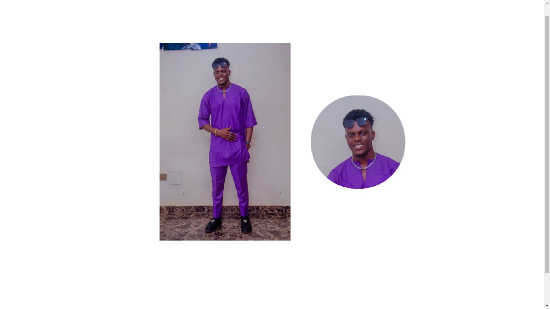

Add “processed with Imgix” after your expression then check Auto crop around face. That will automatically zoom in whatever image is uploaded with the face in the center. You can use the dropdown below it to adjust how close you want the zoom to be. The lower the number, the closer the zoom will be.
Below is an example of the result you would achieve with this.
On the left side is the image I uploaded and on the right side is the final result after processing with Imgix and autocropping to the face with a padding of 4.
