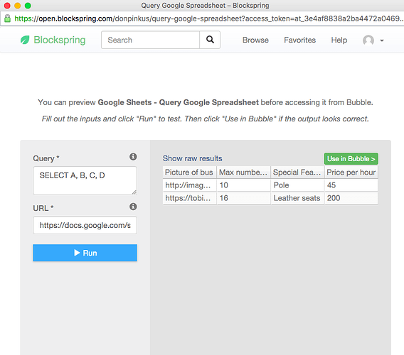

Thanks @NigelG , this is exactly the concept I suspected existed. A few last questions…

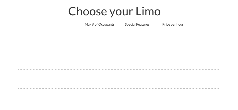

I’ve been able to map everything I believe how you suggested, however, I’m not seeing the data show up when I go to preview. Is this because you have to fully launch the website to a domain before that data will be pulled from blockspring/google sheets?
Also because I can’t see it, I’m not sure if I mapped the images I want shown correctly of the vehicles – I’ve attached screenshots of everything below. Please let me know if this correct.
Thanks!
Blockspring upload:
Mapping:
Design of page:
Preview output:

Everything looks like it is set up ok. Have you formatted one of the columns to be a number ? It needs that for some reason.
@NigelG Yeah I’ve set up both the “Max # of Occupants” and “Price per hour” as numeric, the picture of bus as an image (tried as text too still didn’t work), and the special features as text.
I’ve played with the google spreadsheet sharing, but not sure what else to fiddle with that would change it.
Not sure what to suggest. When it works… it works. Not very helpful I know !
I even removed the plugin and reset everything up from scratch.
Maybe try to recreate in the forum app and we can have a look ?
@NigelG Thanks for all the help-- take a peek: https://bubble.io/page?type=page&name=bus_blockspring_help&id=forum_app&tab=tabs-1
The spreadsheet it’s pulling from is here: https://docs.google.com/spreadsheets/d/1ebg08aUAVqrYhgTr8VPM9KAZCzVfvHBPYSW1fkZzsdo/edit#gid=0
OK, I have updated the Repeat Group so that it pulls the relevant data.
Image isn’t working though, might need to give that some more thought.
