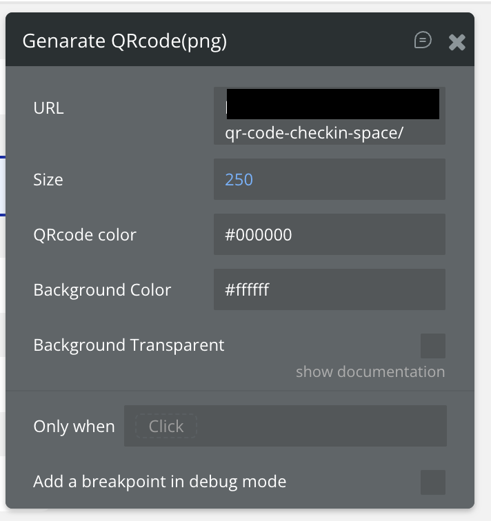

I’m using a plugin called “transparent qr code generator“to generate the qr code for a booking.
Here is how the flow works:
  1. the user books a room and I generate a QR Code for that booking in the booking flow. All good so far.
  2. the user arrives at the hotel and show the QR code for the recepionist to scan.
  3. When the receptionist scan the qr code of the client, it is supposed to land on a page that I already created and dynamically displays the details for each booking. Unfortunately, I cannot pass the booking details in the QR code. I can only pass a link inthe qr code that will bring the recepionist on my page. Picture below.
How can I pass the booking details in the QR code so that when someone scans the code they can see the booking details? Thanks a lot!!

Hi guys,
Thanks a lot for this!! I did try it several times and it loads and 404 error page. THis is what I’ve done.
  1. the landing page is of type booking as you recommend
  2. the qr code has the dynamic booking Id at the end of the url like this. The booking id is correct.
myapp.com/qr-code-checkin-client/1753388722312x108074104422137210
