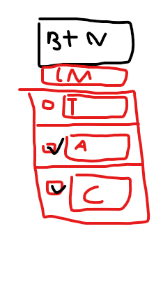

Hello I have a repeating group that lets say have a field for a person names.
Now I have the group repeating 10 times each with various names that are all a record in a db. In the same repeating group I have a check box.
Now I have a button NOT in the repeating group.
And a field NOT in the repeating group lets call it last name field and I type in “josh”
When I click the button I want it to itteate through the repeating group and if the repeating group section has the tick box ticked then I want it to add the last name “josh” to the db for each of the record.
Note the tick box is not stored (not auto binding)
example is just to get my thinking going on my use case.
Thank you!

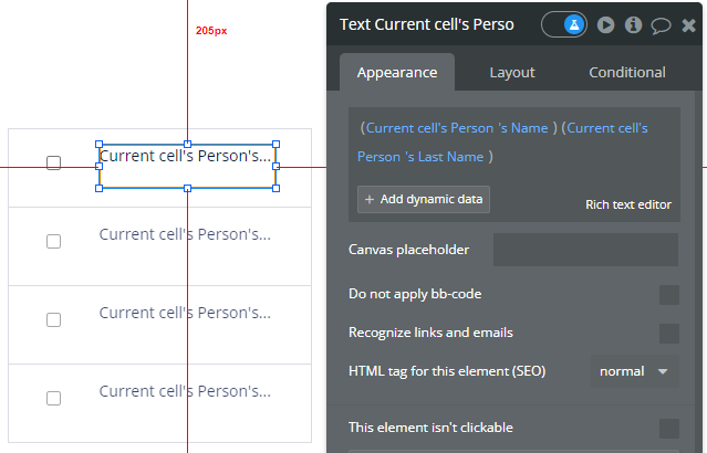

Here is the setup, a repeating group that displays the list of people in the system with first and last names and a checkbox (which is not binded to anything):

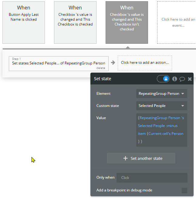

Whenever, the checkbox is checked, you update the custom state Selected People of the repeating group:
And you do the opposite when unchecked:
Finally, when the apply button is pressed, all you need to do is make changes to a list of things which the things are the selected people custom state of the repeating group:
