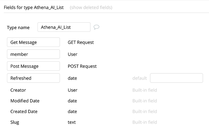

- I also played around with few data types and elements in it including POST & GET request within the database. But no luck. As you can see with things being all over the place, I’m a bit lost.

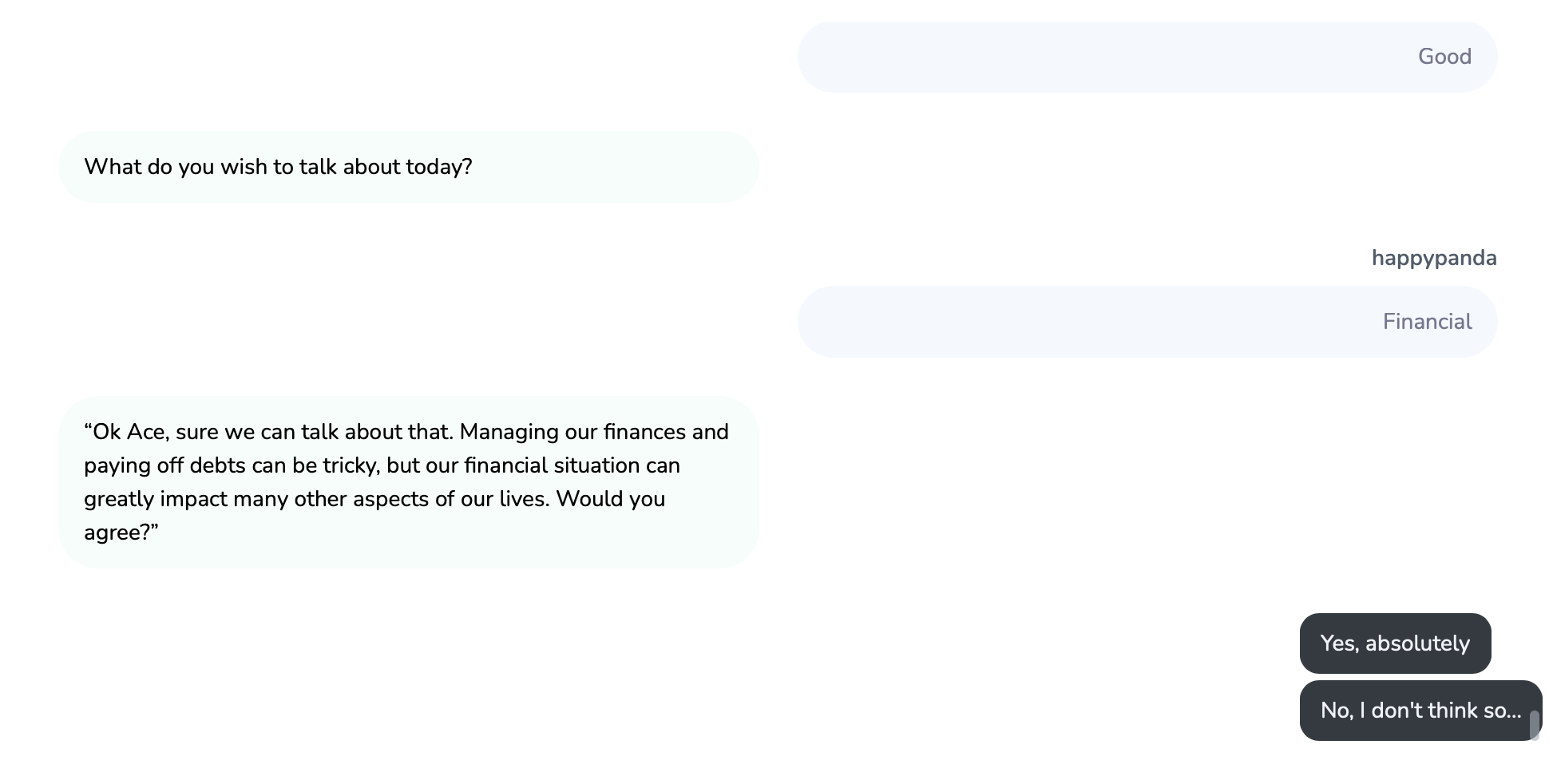

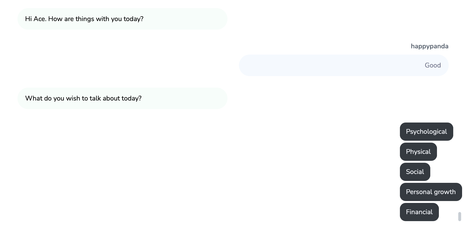

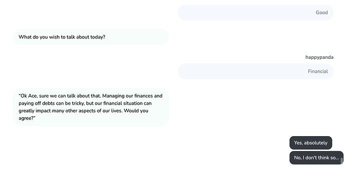

Yes, when someone sends a message then the custom bot will reply instantly through the api. Some of the responses are also button based which means the bot might ask the user to select some option based on a question it asked and The other times it’s just a normal chat conversation text based.
A live conversation example from a separate angular deployment. The image where it says “Finance”. There were 6 button choices there like the other image and once the user selects a particular option then the AI then diverts the conversation to that topic. So it mixes choice based responses and normal text.

The GET request is related to the conversation history so its more database related and pulling chat history.

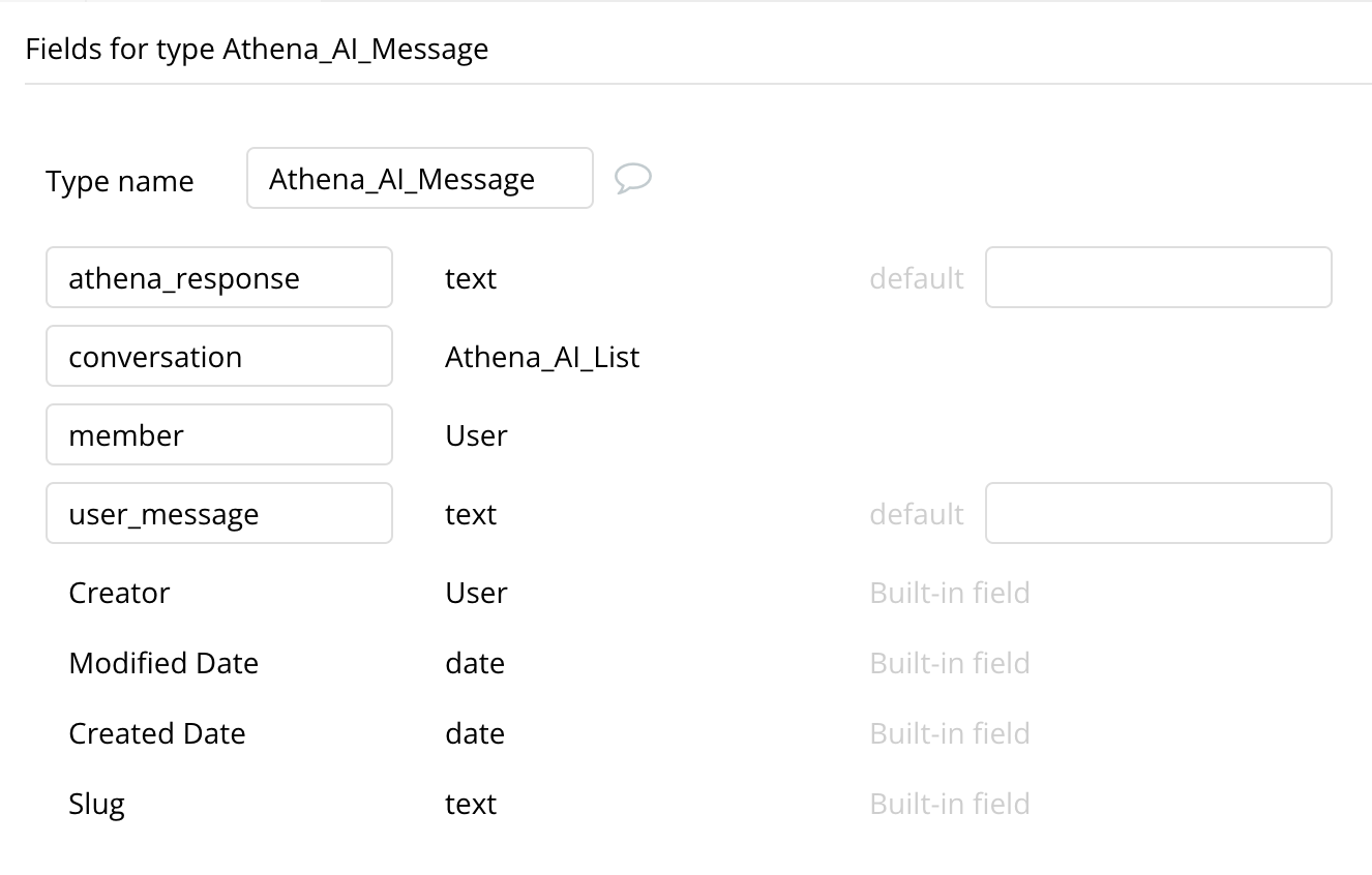

Is this what you meant for the database?
