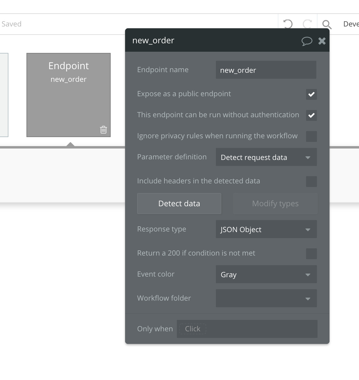

I’m trying to receive and create new thing in bubble from Shopify webhook.
I have created the endpoint and created the webhook in Shopify but when I use the “detect data” option (meanwhile I send the test webhook) nothing will happen.
Here some image of my test:
Here in Shopify
Here in Bubble
The strange thing is that I have also tried to don’t use the “detect data” and just create a new thing with a pre-determinate value and when I send the request from Shopify the webhook work and a new thing is added in bubble database.

Try these steps …
  1. Set the url in shopify to …/wf/new_order/initialize , as you have done.
  2. Press the button in Bubble “Detect data”. A popup will come up.
  3. Click “Send test notification” in shopify. Bubble will receive it and treat it as a template to create a data structure (hopefully). This can take a couple of minutes.

Maybe the webhook request doesn’t include a content-type header? Or maybe the message is gzipped? idk why Bubble would ignore the message though.
A possible workaround is to set manual parameters, add a parameter called ‘id’. If you can retrieve the event id, you could make an API call to shopify and retrieve the rest of the event details.

Do you see anything in the server logs?
What do you mean, the endpoint didn’t get invoked, or it did get invoked but didn’t see the parameter?
If the parameter is set as mandatory, it will reject the request if it wasn’t able to retrieve the parameter.
There isn’t an automatic verify option, so you need to read the webhook first before being able to verify it.
Turn on ‘Include headers in the detected data’ to retrieve the signature digest. Bubble has a text function to create a HMAC SHA256 digest which you can compare to the received one. This will be useful when the endpoint can read the message body properly.
Actually if it can capture the headers, it might help understand what is going on, for example if there is a missing context-type.
