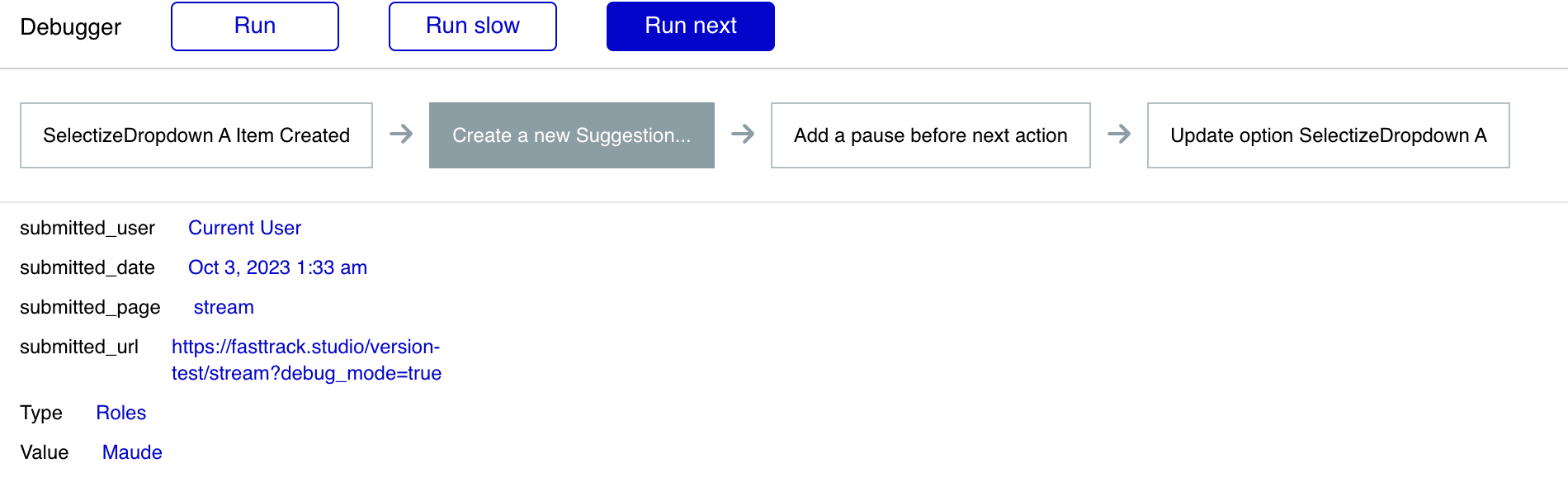

Hi @Jici ,
We’re seeing some inconsistent behavior with creating new values. We previously got it working with this workflow:
But I discovered that the list of ID’s (referring to database things) does this thing where if you add an existing item first, and then create an item after, the created item will show up in the list in the debugger, but completely blank:
The values are populated & show up in the visual component, but Last Value Added is somehow a “thing” with no content, no unique ID or anything. When we try to save the list to the database, the blank item is not saved.
Perhaps even more strangely, when we try to create another item, the previous item that was blank is then populated with fields & can be saved, while the newest created item is now the blank one. In running the debugger, it shows the correct values being set, and the run that results in the previous item being populated does not indicate that it’s being populated anywhere in the workflow debugger.
(this value then becomes a “blank thing”, until a subsequent value is created)

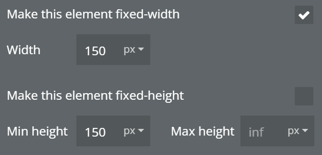

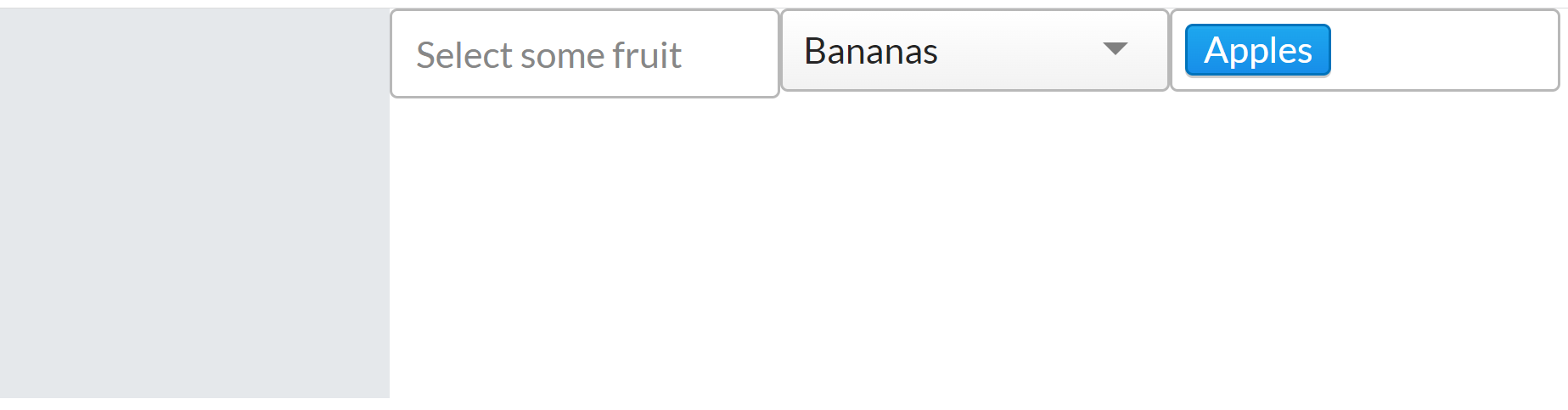

I’m having consistency issues with the height of the Selectize element. Especially in the new resonsive engine.
It seems to completely ignore the height value - all of these elements are all set at 150px x 150px, and only the square is at the correct dimensions. Secondly, once you select an item alement is also about 2px shorter.
So, to fix this, I’ve added input padding of 65.5px to the top and bottom - the height is now roughly correct, but as soon as you select an item, again you lose about a 2 pixels height for single input and multi input loses all of it:
Adding padding to multivalue item padding fixes our issue, but there’s no option to do this with the single input - we still lose about 2 pixels:
Is there a workaround for this - how do I stop single inputs losing the 2 pixels?
UPDATE
So, for anyone else having the same issue, I’ve found that the workaround is add some CSS to the page - in my case, the following worked for selectize elements which are supposed to be 42px high with 15px font:
.selectize-input{
     min-height: 40px;
.selectize-input .item{
     line-height: 18px !important;
