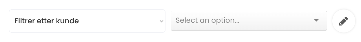

Im getting a weird behaviour regarding the size of selectize dropdown, when there is no value selected height of the dropdown is ok but when an item is selected the height drops. Im using fixed heigth in layout settings? Se below images:
Any idea why this could be?

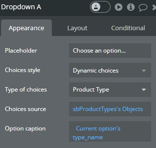

I am trying to extract a number id from a dropdown, but it is proving difficult.
My workflow adds a product to a supabase product database. In this DB I have to foreign keys linking to other DB’s, namely suppliers & product types. These foreign keys are in number format, related by ID.
As a test I have a standard dropdown with a DB as source
and a selectize dropdown with a similar DB source
On the workflow the JSON payload is
The issue is that the standard dropdown parses the id value as a number without issues an adds it to the database. The selectize dropdown throws an error
and does not seem to parse the number.
Can anyone please point me in the right direction as to how to do this. In a nutshell I am trying to extract the ID from the selected dropdown name value.
If it helps I am using @Nass (nocodegarden’s) supabase plugin. @Thimo @Jici
I have the same issue. It does not seem to respect the layout values. The drop shadow settings also seem to be ignored for the dropdown tab.
You don’t seem to use the id in the ID field of selectize dropdown(you set it to name). Also, if you are not using bubble database, you will.need to id all id text. All id or last id are only for bubble things
Thanks
The plugin only seems to accept text values, or am I mistaken? The id (number) is pulled from the database, but not shown as an option in the plugin.
Could you clarify what you mean by “id all id text”
An ID should always be set as text. Even if this is an interger. If you use API connector, you can modify the type of ID.
