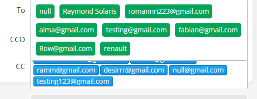

Hello! Great plugin, i’ve been using it for a while and its great!
I have come up with an issue tthat is bothering me and cant seem to find a workaround so far. I am not a coder so maybe havent tried hard enough…
When a lot of options are selected the input box size keeps increasing but the page and the elements around it dont update causing it to start overlapping to elements below. I tried using a range for element height but as soon as I ad an item, the item visually dissapears and the input box returns to regular size
Even on the demo page you can see how adding a lot of items will make the field overlap the elements below.
I am using this for an email form and I have the TO, CC and BCC right on top of each other like most email forms
But when I create a lot of items into the TO field it starts overlaping the CC field below
I even tried doing Conditionals on the selectize element to change Height when Item Count is more than 2 but when the condition evaluates to true all the items visually dissapear and the input colapses to the original empty height.
The only “workaround” I have found is to set the height to a larger fixed amount.
Not only does it look horrible
It doesnt even fix the issue…
do you know what I could do to get this issue fixed? Couldnt find anything about it in the topic.
Thanks!

You should remove fixed-height and try min-height, no max, and set fit-heigth to content. Be sure parent also have similar settings if needed. Also, use bring to front to be sure it’s above other elements (could be done on the parent group too if needed)

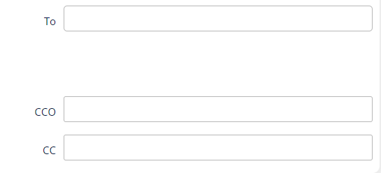

I originally did this setup on the element. The parent group is also fitting to height.
image|321x130
For some reason, on this setup, when I add the FIRST item into the dropdown, it visually disapears from the field and the input field collapses to empty size.
If I set NO max height or a specific max height the result is the same, it wont add the elements into the dropdown
If I want items to display I have to set max height or it just wont work.
