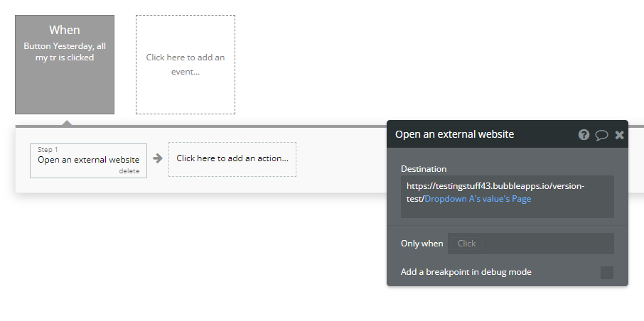

Or if you want to go more dynamic:
Create an option set like this (pls note extra attribute page):
The dropdown uses the option set:
Add a workflow action “Open external website” and use the option set parameter page in the URL:

Btw, sending URL-parameters is still possible with solution 2, you just have to define them yourself like this:
