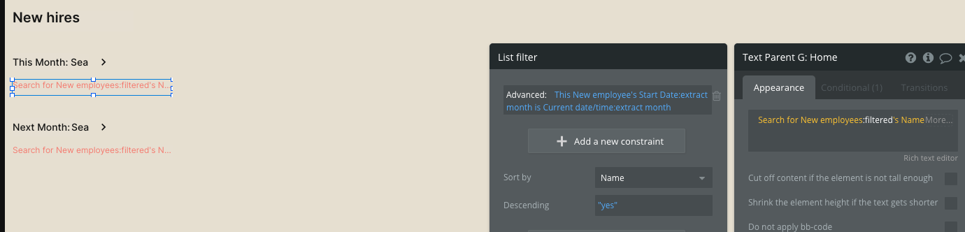

I am having trouble setting a filter on a repeating group. I want the group to show only the new hires (name) incoming in the current month - one name per row.
At the moment this is the closest configuration that I have been able to get to:
Screenshot 2020-06-08 at 21.42.08
Setup:
Any help very much appreciated.
Thanks

Is there a reason you’re doing the filtering client-side as opposed to using constraints in the search that’s specified for the Data source property of the RG?
I’m not sure I totally follow you. Are you referring to adding the filter to the RG instead of the Text?
There is no specific reason that I am applying the filter where it is at the moment, I am new to bubble so this is my first time trying to add constraints/filters
Thanks

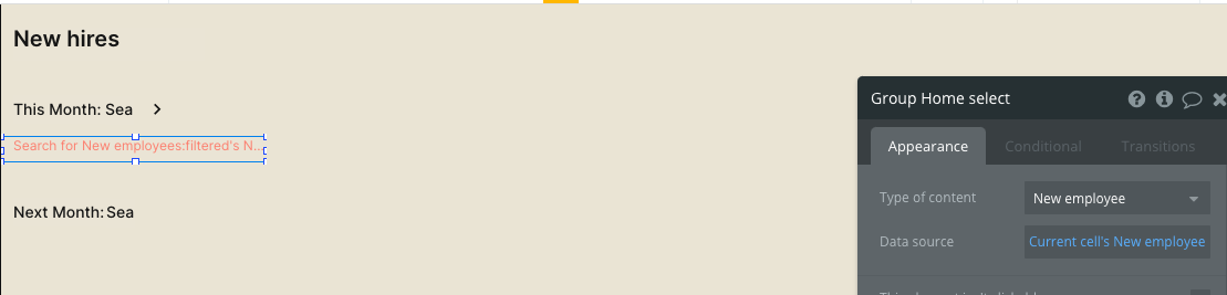

I was just curious, what does the Search for New employees expression (for the Data source property) look like? Can you share a screen shot? Are there any constraints there?
at the moment I have it like this:
One approach would be to specify your filter where it says Add a new constraint. That “filtering” happens on the server when the data are retrieved from the DB, as opposed to happening in the browser after the data have already been retrieved. Do similarly for “next month”.
Alternatively, you could retrieve 2 months worth of data from the server and then use client-side filtering to split the search results into “this month” and “next month”. That way, the server is being hit just once, and the results are further “refined” (filtered) for each RG after they get to the browser.
Either way, you’d specify start and end dates (either one or two months) in the search constraints.
