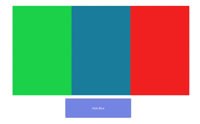

I have a large (wide) RG and want to give the user the option to hide/show RG fields
like in this video example is that possible?

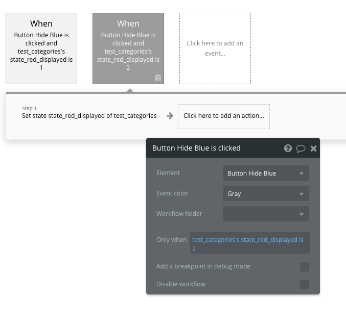

I would imagine you can put those fields into groups, then collapse the group (toggle) when the button is pressed. I collapse full RGs, but haven’t tried this yet. Should work though

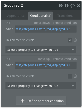

You would have two groups. Each group is going to have a repeating group inside with the same datasource. Your data in each column is the parent groups things thing…whatever the data fields are. Then use the custom states to set the hide/show function by using a conditional on the group that is pointed at the custom state. The button when clicked will set the custom state. Then you can show the column again by pressing the same button using conditionals on the workflow based on the custom state.

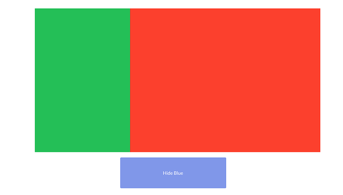

The toggling works fine on the button
but when I have 3 RG next to each other, and I toggle the one in the middle it is only hiding, not “connecting RG 1 and 3” like it will do when you have a floating group and shrink when hidden is ticked.
How can I “connect” the shown RG’s when there are hidden?

@troy.roberge the collapse height when hidden doesn’t move elements horizontally, only vertically (ie: collapse height)

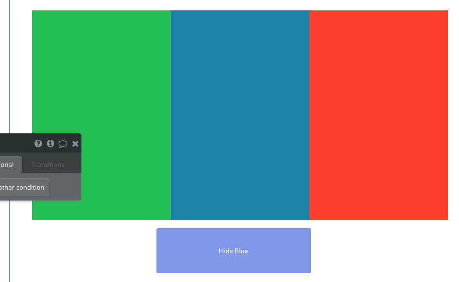

So to actually get the functionality @marco1 is talking about getting the columns to move horizontally, he would need to have groups that are hidden and displayed based on custom state settings.
Basically in my example of three groups on blue in the middle, he would actually need two red groups…one to the right of the blue, and a second in the same place as the blue and set custom state to hide and then show again.
What you get is the functionality of moving the groups horizontally on the page
