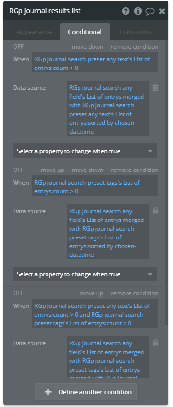

Sorry, I meant ā€œconditionalā€ area. All the elements have them. Here’s an example from a repeating group in my app
I’ve got different searches which are run when different conditions are met. There’s also a default search, but that’s not strictly necessary. Depends on what you want to happen when.
Ah okay cool. Should’ve thought of that.
