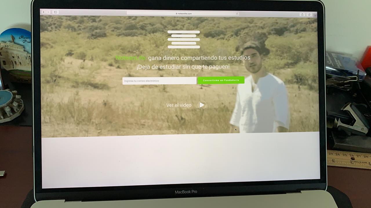

Hi!
My app looks like this on a Macbook pro 15inch 2880 x 1800.
I designed my page for 1600 width.
Is there any way of stretching the elements on my app so that they fit better on the Macbbook pro without having to create a brand new design for 2880 x 1800 (or larger like 5120 x 2880)?
Try adding max width of elements such as input and button.
What about the height of the page?
