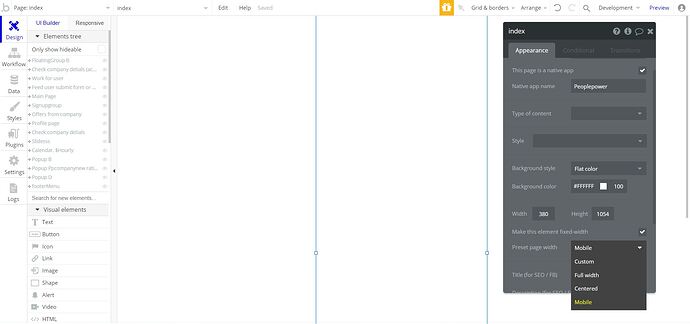

Hi, I have a problem only with Iphone Plus models with screen size which has 5.5-inch screen size…
my with on mobile app is 380 W
Also “Make this element fixed width” is checked
Do i need to make app width wider than it is now ?! (more than 380 w)
What are the solution ?!
Thanks!
Best approach creating a web app will be removing ‘make this element fixed-width’ so it can work on iphone5 and higher. The rest of your page will be adjusted with responsive settings.

You mean to change “mobile” to some other option?!
or just uncheck ‘make this element fixed-width’
sorry don’t get you
Thanks for that
already changed
Thanks
I used Custom 320x560. Then I designed the rest responsive.

and used Floating Groups. Everything will depend on your design.
21%20PM
Thanks for your suggestion, it worked with floating groups but after that come up new issue which is all about sizes of the fotos
