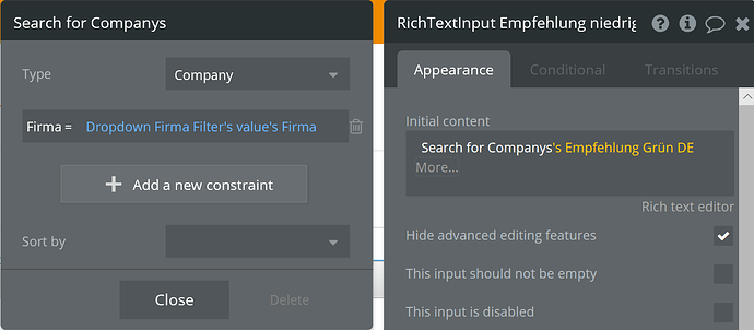

  1. Selecting a value from the Dropdown on the very top loads text inside two RichtTextInputs as shown below
Settings of the Dropdown
In the RichtTextInput I do a search for Company with a constraint Dropdown’s value
Including the script to hide some Icons in the bar works fine without selecting a value from the Dropdown.
Problem: Neverthenless, as soon a value from the Dropdown is selected the hided Icons are shown again.

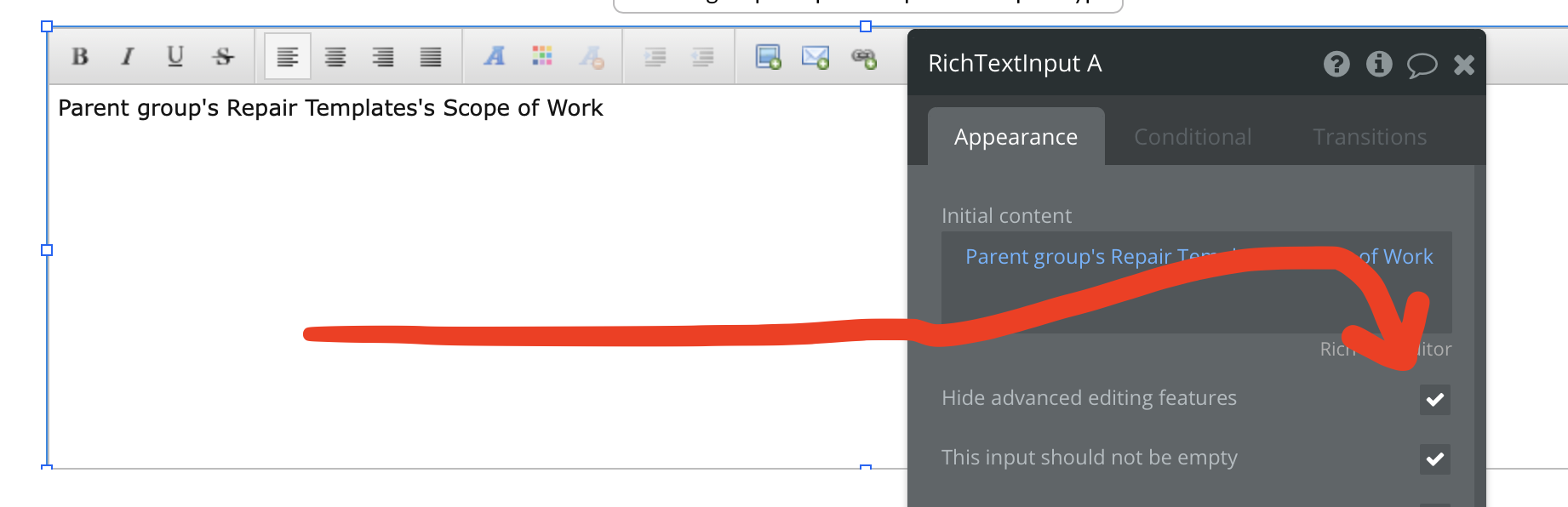

Hi All, I think I found a workaround to solve this issue. I simply disabled all toolbar features to prevent any HTML from showing up in my final documents. I disabled all features that create HTML - including Bold, Italics, Underline, and Strikethrough. It’s a bit of a hack - but here’s what I did.
Step 1. Check the box to disable “Advanced Editing Features”. This gets rid of font, bullets, etc.
Step 2. Add a shape over top of Bold, Italics, etc. to hide them and kind of disable them from users.
Step 3: Make sure the color matches the toolbar snd the shape is brought to the front.
That’s it. Here’s the result:
