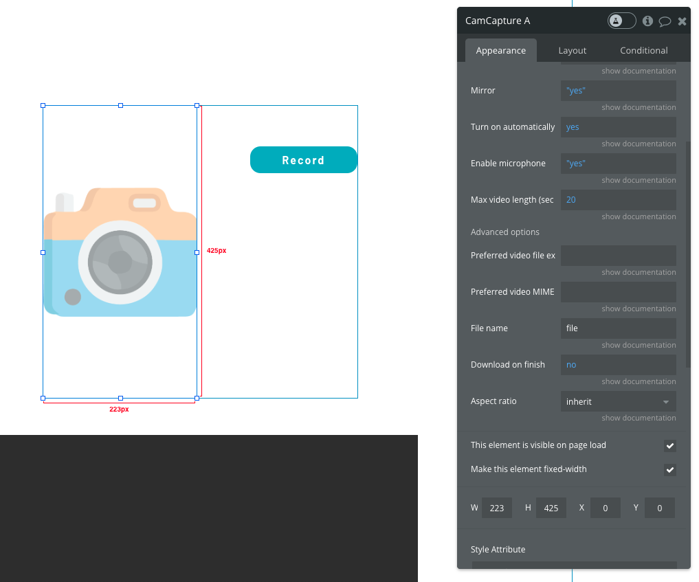

I’m using a plugin called Camera Capture and need to rotate the viewer window into portrait orientation. There is no way to it from the plugin- would this be a CSS thing? If so, could anyone help me out?

On the video recorder plugin, you have 16:9 aspect ratio (landscape) but no 9:16 (portrait). You can do inherit and then size the capture element to 9:16, but it treats it like it’s just cropping a widescreen video and isn’t centered in the camera.

While the video is now centered when you resize it to be in portrait mode. The “Inherit” setting no longer appears to be working. It doesn’t output a video at the same aspect ratio as the element size.
You can test what I mean here: Your Bubble app
Just record for a few seconds, hit stop, wait for it to populate the video player, and notice that it records 16:9 even when it is set to inherit element size.

Unfortunately, I have updated to version 1.22.0 and the issue remains where I have the Camera element set to inherit element size, and when I record the output video is defaulting to I believe the device aspect ratio, it’s widescreen.
Screenshare of issue: https://tella.video/camera-capture-bug-esno
Please test the link that I sent earlier: Test Demo
Simply hit record, then stop, then the video player will update with saved video. It is widescreen when element is vertical. I am using Chrome on a Macbook.

As we mentioned earlier, the plugin was designed with this functionality that you mentioned in your video.
We will add this request to the list of plugin improvements and our dev team will verify if the plugin library allows that and check how feasible it will be to include it in the next plugin update.
