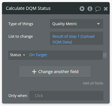

I have a workflow running on a list of records.
I want to make some additional edits once the first run is complete, in this case I want to be able to add data based on the previous values.
The first pass inserts the data.
The second pass calculates a [Total] value based on the inserted data.
The third pass needs to allocate a value to [Status] from an Option Set to each row based on the ‘total’ value.
I presumed the best way to do this would be to set up a conditional.
Something like: Status = On Target Only when [Total] > 80.
I can’t, however, see how to run a conditional on every row?
Any suggestions?

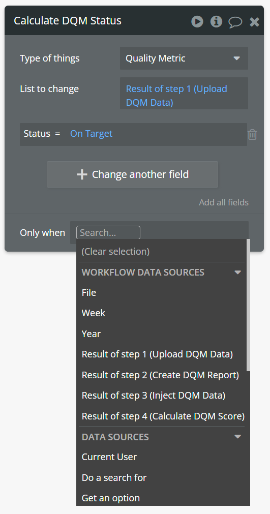

set condition to ‘‘each item on list’’ this will capture each item on the list
That’s not presented to me as an option, unfortunately.
I can select the original list but that is effectively: Each item’s [Total]
However, if I select the first item, it applies that logic to all rows based on the outcome of the first row, rather than running that logic on all rows.
I’m at a loss.

The list the action is being run on is from a CSV upload.
Each row in the list comes from that file, then is added to a database, but this is all part of the same backend workflow. It does populate an RG, but it’s an inefficient way to pull the data back into the backend.
