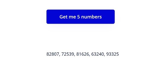

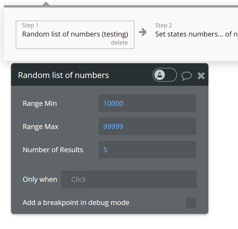

Plugin is much easier, it can return the list you want easily in one action with some Javascript, what is your app name :rofl: :rofl:
ultimatelottery, it’s not on a paid plan I’m just sandboxing trying to figure out the lottery elements before maybe nesting it in a bigger gambling app
okay click “Add plugin” and it should be at the top of the list
Thank you! lemme check it out
To be completely fair, using Javascript to generate the list in one step is the best approach. It’s just not very bubble. It takes a few lines of very simple code and you would avoid having to run the recursive workflow. :slight_smile:
That plugin is super handy @tylerboodman thank you.
