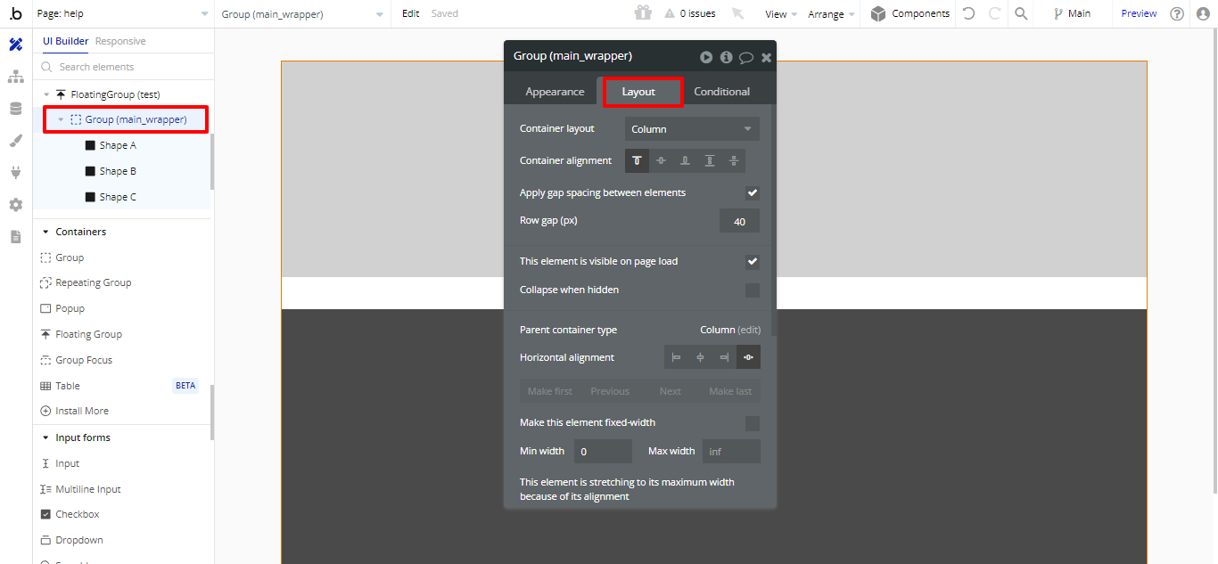

Simply wrap all the content of the floating group/popup inside a group.
Here’s an example (from the elements tree)
So instead of attempting to auto scroll the “floating group/popup” on button click
you now have to auto scroll the Group wrapper…
please don’t forget this … also remember to remove the I.D attribute “scroll” from the floating group (from your initial setup )
The work flow remains the same , make sure you are referencing the right element…

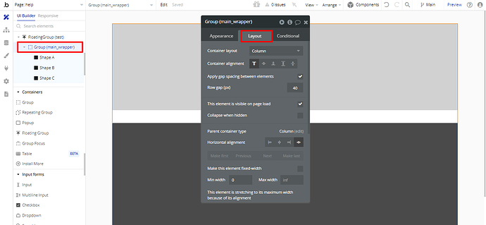

Thank you very much Victor for your time showing the steps, unfortunately I did the same you show but I don’t have the same results.
Only I can add that inside the pop up I have more groups (3 level of groups). Could be here the issue?

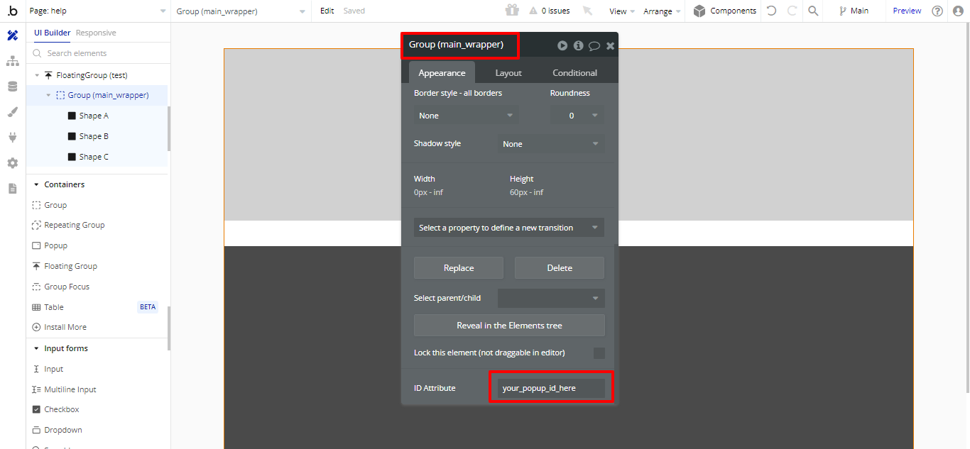

I put the id to de wrap group, and leave the group with the settings you are showing.
The others groups inside I unchecked the auto scroll and the fit with the height. Because if alI check it, the pop up scroll by each group and not like an entire big group.
Ok just for close the topic, first, LET ME SAY THANKS TO @startups.victor, He keep helped me by message until the problem was solved, he reviewed and troubleshouted my app friendly. Thankyou very much again Victor.
Here the solution. (that complement all the remmended above)
