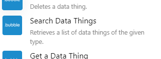

I’m trying to get the data from the user list of things via Integromat. There is the option in Integromat that says “Search Data Things”.
I’m trying to get the users Unique ID to do an update via Integromat in a user field. But I can’t get it working.
It looks not that difficult but I can’t get a list of things.

It was so simple. The only thing needed was to put the data type User in the Type Name field. And nothing else.
That gave the complete user list from Bubble.
