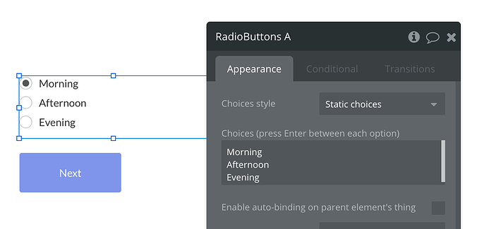

If you have radio buttons which allow a User to select a static time of day for example:

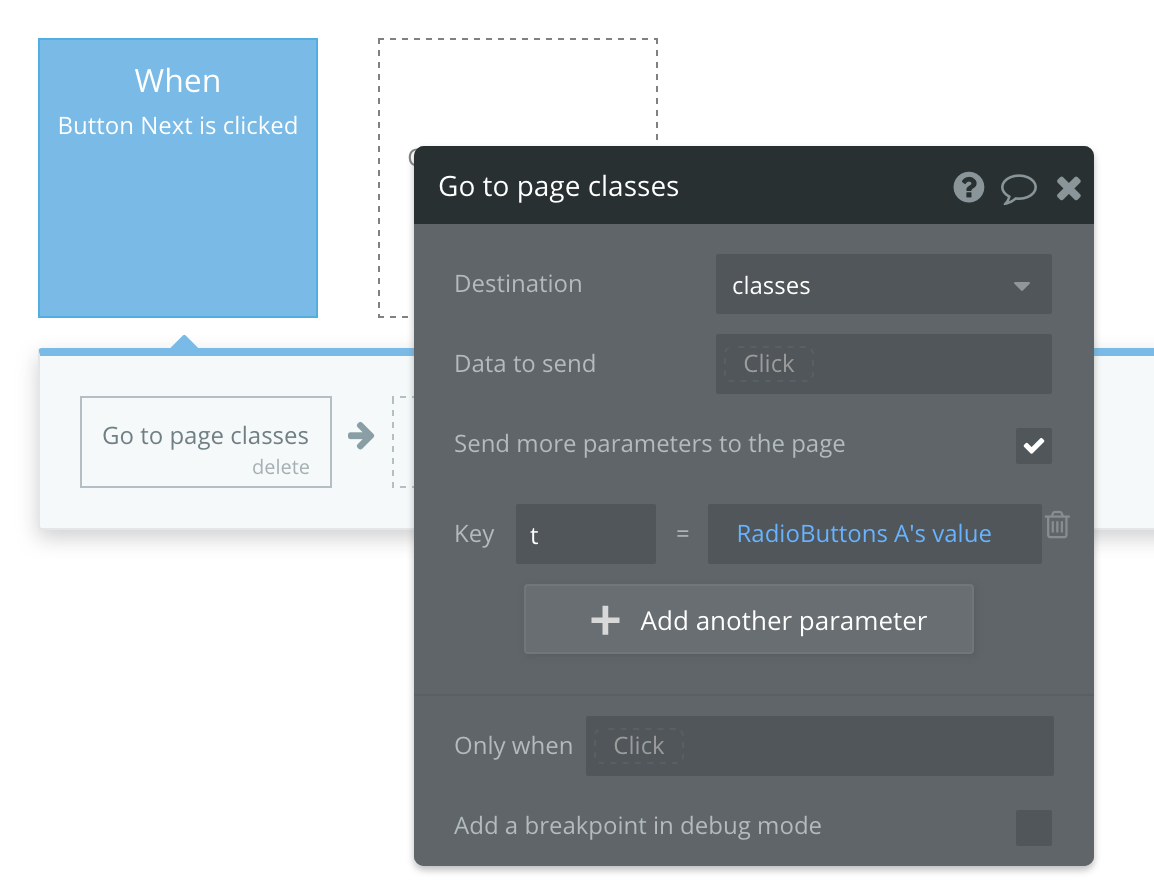

Then you can send that as text to a different page:

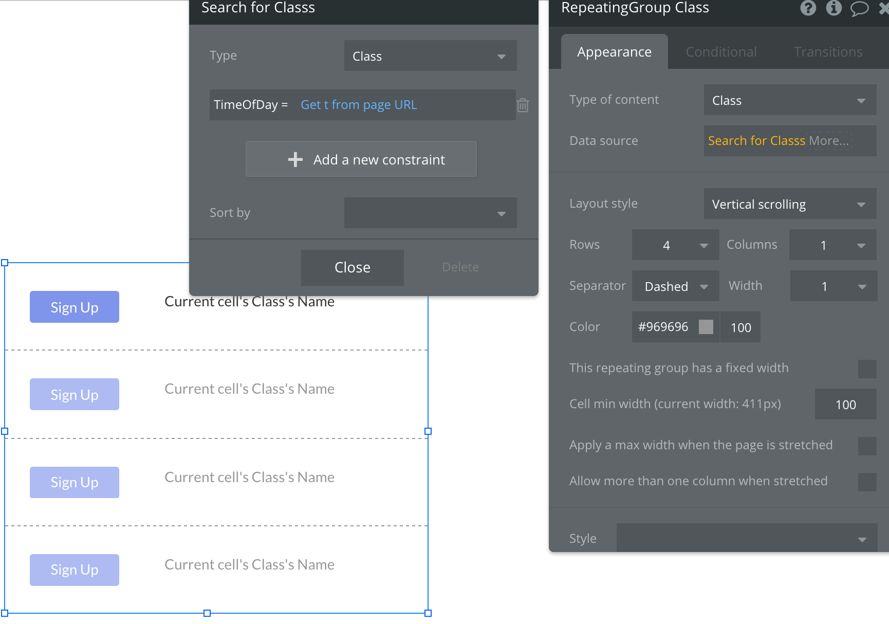

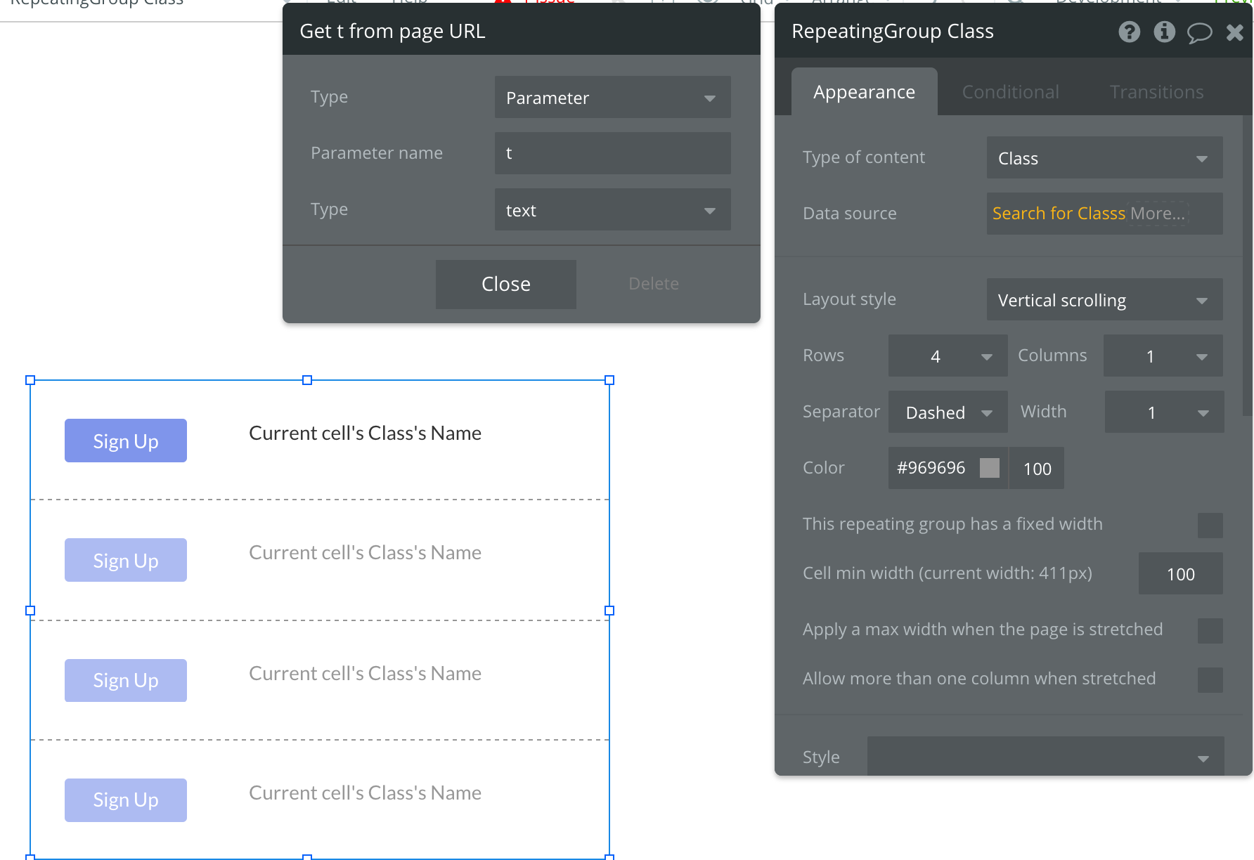

On the classes page, you could then perform a search for classes whose time was the selected value sent as a parameter:
(this is what it looks like when clicking ‘Get t from page URL’)

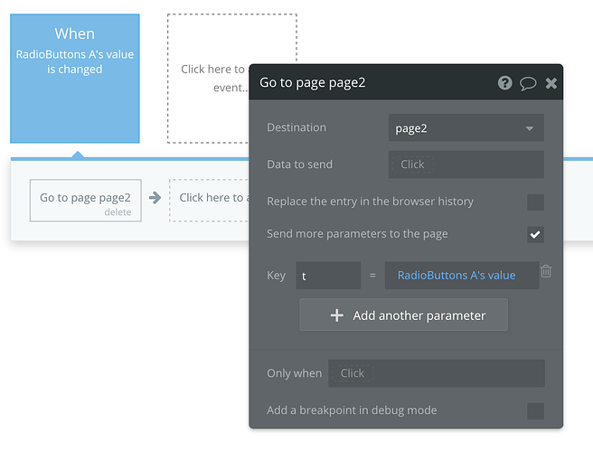

In my example, the t parameter is sent to page 2 which is used to filter the repeating group on page load - but as that parameter value changes, the repeating group will also change. So the User can continue to filter the results on page 2, and have the repeating group update based on the parameter change.
For example, if a User had selected ‘Morning’ on Page 1, but then switched to ‘Afternoon’ while on Page 2, you would use the action:
“When Period of Day is changed”
Data → Go to Page: Page 2 (staying on the same page)
Parameter: t = Afternoon
Then the repeating group would show all of the classes with the Afternoon times immediately. Since you have two other filters for MultiDown Box and Dropdown Box, those dropdowns would each have separate parameters (so you could have a, b, t) for example, or any letters you prefer to represent the parameters in the URL.
Is this closer to what you had in mind to set up? :slight_smile:

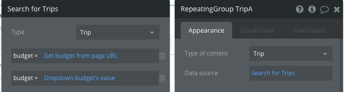

The simple method is to set the filters default values from their corresponding parameters, and then filter the repeating group based on the filters values (not the parameter). The main downside is that Users can’t hit the back button to go back to previous search queries; hitting back will take them back to page 1, even after adjusting the filters a few times.
Alternatively, you can have the filters adjust the URL parameters directly; this enables the User to hit the back button and go back to their most recent search. So if a User had a $100 budget and then increased this to $200, then hit back - they would go back to page 2 showing the $100 budget results - instead of being taken back to page 1.
For the budget filter dropdown, you can do this by setting up a workflow such as:
“When an Input’s value is changed [Dropdown Budget]” --> Go to page: Page 2 (this will not reload the entire page, it will only adjust the parameters)
Then send the current parameters:
budget = This dropdown’s value.
[parameter2] = [parameter2dropdown’svalue]
[parameter3] = [parameter3radiobutton’svalue]
Then the repeating group constraints would be only in the format of “field = get data from page URL”, not the filters’ values. The only tricky thing is if your filters aren’t mandatory. Then (I think!) you would need to create conditional ‘Go to Page’ actions which send only the parameters that aren’t empty. This was my experience when setting this up previously, so may be best to start with two parameters and test what works.

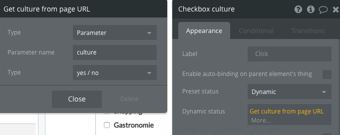

And for the checkbox, here is what I did:
On page 1, the culture parameter I send is set like this:
or like this:
I tried both, but none works, not sure I use the checkbox properly :confused:
