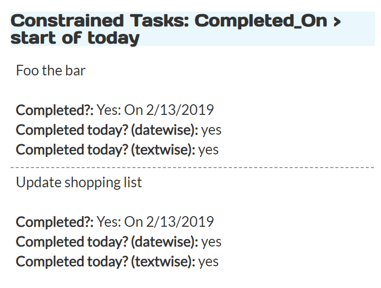

So, we know a way to get Completed tasks that happened today. That Search is like this:
In my sample app this yields just the Tasks that are complete but where completion happened today:

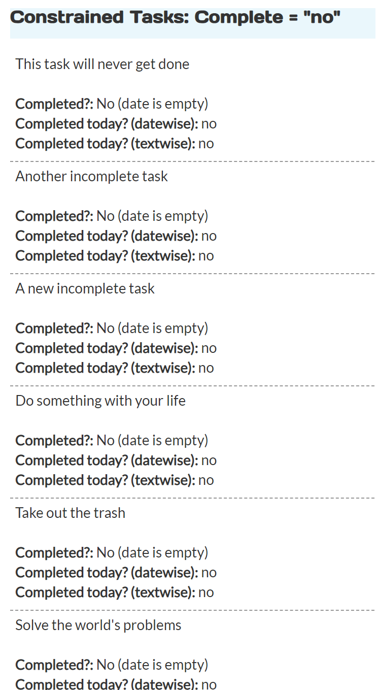

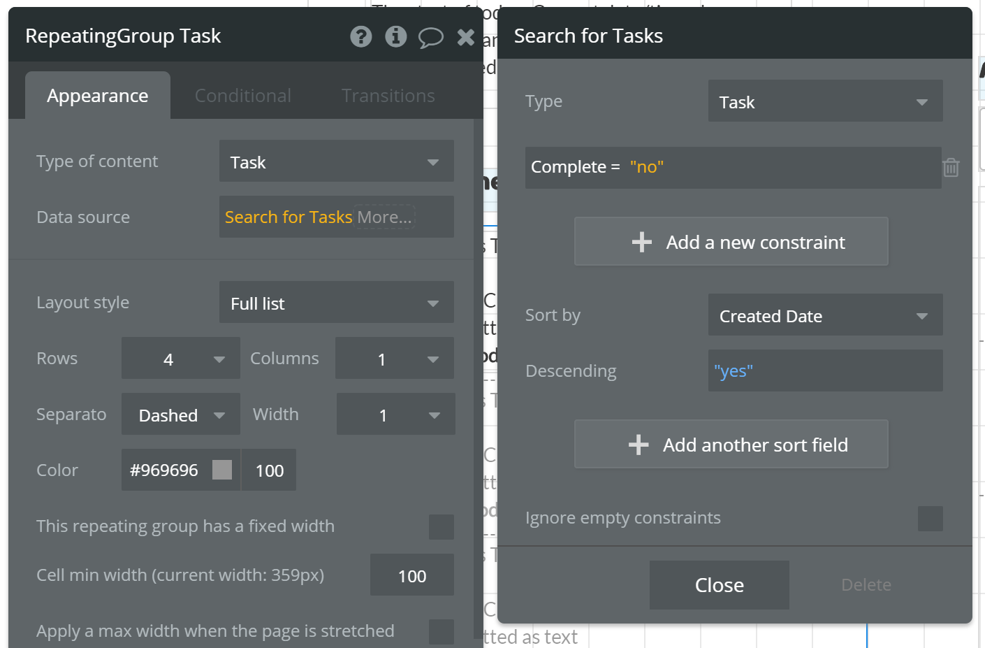

Now let’s get the Tasks that are NOT complete:
This yields:

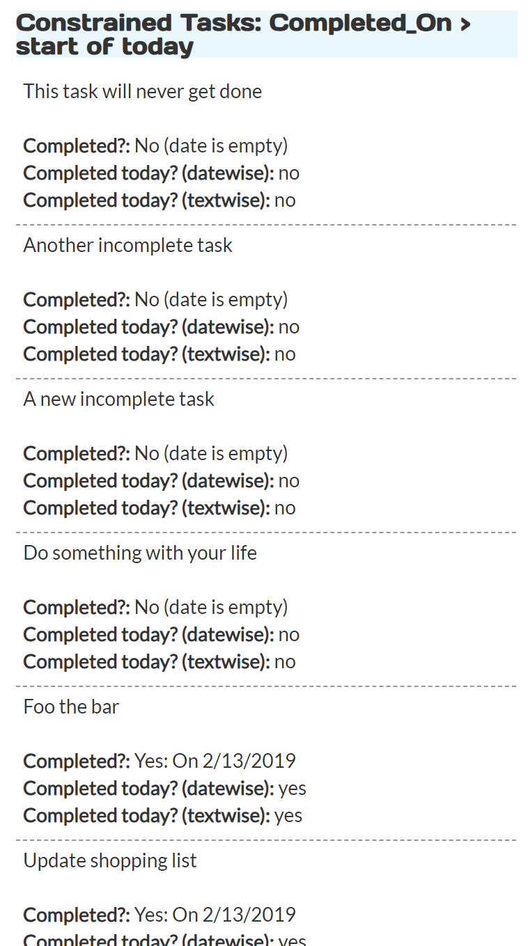

Now let’s combine those:
^^^ the first search has the “Completed_On > start of today” condition. The second Search has the “Complete = no” condition.
This yields a list of Tasks that got completed today combined with a list of Tasks that are not completed, as we expect:
