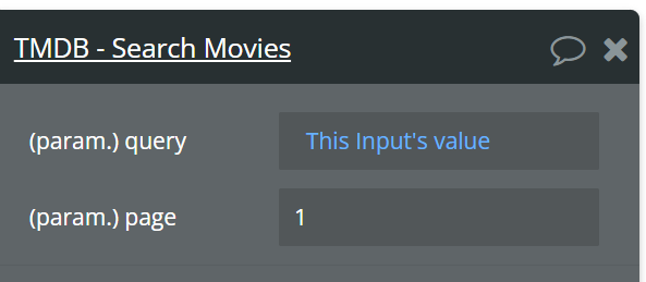

It doesn’t have to be in the same repeating group. I’ve actually set up a separate repeating group that shows up when Info is typed in the input bar
You just have to setup another API call to search their database: Search - Movies
Then add an input box, then when you do the API call the input’s value will be the query parameter value :blush:

You have to initialize the API call with a query value and make sure it returns at least 1 movie so Bubble learns the structure. Otherwise it returns nothing and Bubble doesn’t know there’s more data
Would this be on the query section of the moviedb.org? I didn’t see anything in the value of your API query parameter on Bubble
Yea I had a value in the API Connector for the query parameter just to initialize then I removed it. But then you dynamically add the input’s value when you do the actual API call:
