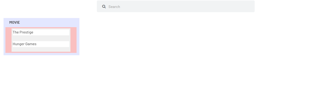

I will show you a screenshot, it be more easy for you to understand:
Blue box = RG A
Red box = RG B
With your solution, the search bar will search in the blue box title “movie” so it will only work with the word “movie”.
The other solution will be to apply the search on the red box with for example “prestige” but then it will not work anymore with the word “movie”
What i want is to make a search on the red and the blue box in the same time so the words “movie” or “prestige” will both display the RG A on the page.
let us call movie genres
and the prestige and hunger games movies of that genre.
Your outer RG if input search is not empty should read:
do a search for genres (containing inputs value) merged with do a search for genres: filtered advanced filter this genres movies titles contain inputs value
By the way: with “advanced” contraint, it’s not possible to use “Contain Keywords” but only “Contains” so if i type “prestige” it doesn’t display “The Prestige” but if i type “The Prestige” then the RG is displayed.
I am realling making progress but still stucked with displaying RG A and also displaying results containing keywords and not only the exact value of my search box.
