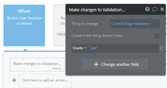

No problem at all! :slight_smile: If the code is valid, the workflow could be:
“When Button Usar Voucher is clicked and when Search for Validations: count is 0” --> Make Changes to Thing --> Thing to Change: Current Page Validation, Usado = “yes”
Then the other one is:
“When Button Usar Voucher is clicked and when Search for Validations: count is not 0” --> Make Changes to Thing --> Thing to Change: Current Page Validation, Usado = “no”
If you have a workflow with only “Button Usar Voucher is clicked” that workflow will run every time that button is clicked, so it’s best to use the additional “and when” statements to ensure that the correct workflow you need occurs when the button is clicked.

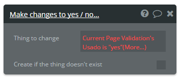

Thanks for your answer fayewatson!
Here’s my issue where I’m stacked. I tried that, but it seems something is missing on my actions:
Thanks for all your support!
Regards
Pedro
Ok, I think I did this well, but the database record is still no changing.
error could be:
  1. because first I’m clicking on “Check if valid” and it shows a message “Valid” if condition is true and then it enables a button “Validate it”. (anyway I put it in the first button and still doesn’t work)
  2. something else is wrong.
