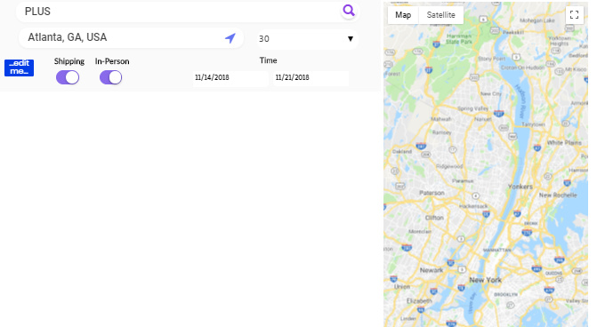

I am trying to imply filters such as location and for some reason I am not getting any results with the constraints.
I am trying to add filters such as location, distance in miles, category shipping and in person delivery.

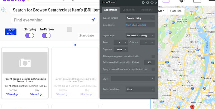

The RG you are loading should have ‘Main S&A’s matches as its source.
Solution 1:
Do not add any constraints. And have it find the user’s geographic location
Going to find a way to add filters to affect the search next.
The Full Solution:
You do not add any constraints to the Search and Autocorrect settings (Picture 2) ; you add them to the List of items Repeating Group by using “:filter” (Picture 1)
