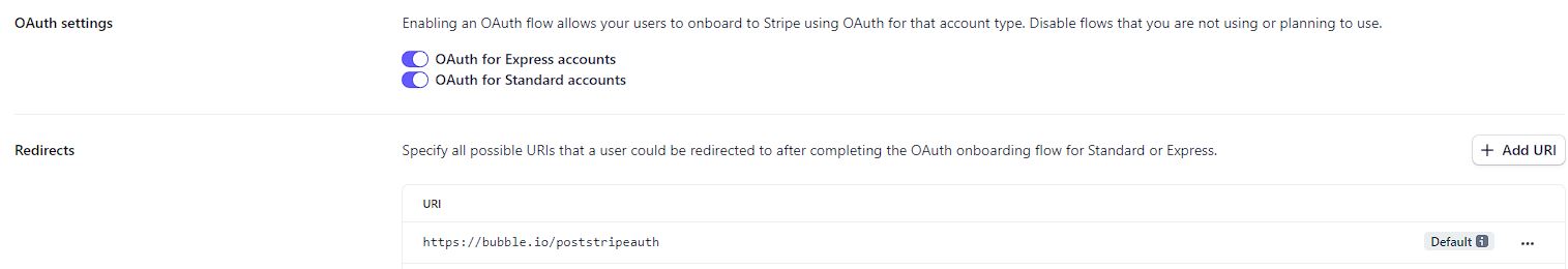

Hi Mac
Unfortunately, this is looking as-is, as you have mentioned, any other ideas at all that can help me? Just to confirm for you - I am in test mode within connect currently. Using all test accounts to process the ‘transfer’.
Stripe Authentication (starting with “https://”)
(PLEASE SEE PICTURE BELOW)
Would be very thankful to getting past this one!
