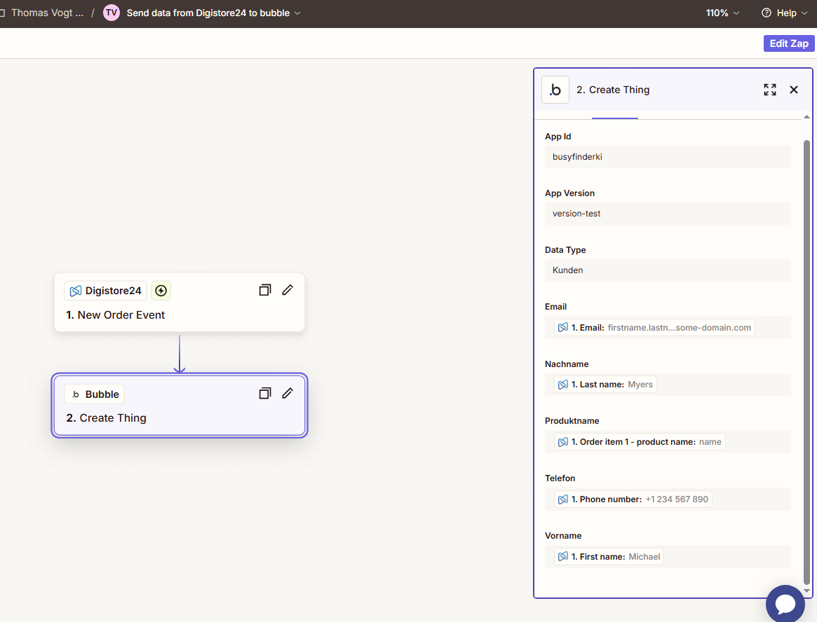

This is the result of the Zap when a purchase was made via Digistore24.

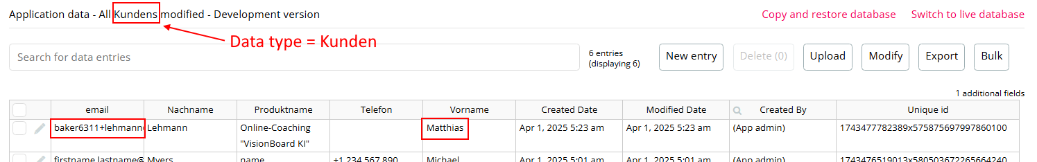

Here are my data types for better representation
If I understand correctly, I need to create a bubble user from the data that Zapier creates in the Kunden data type. Is that correct?
