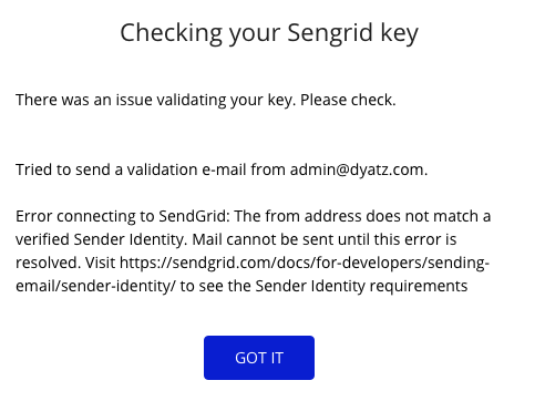

When authenticating sendgrid, bubble seems to have hardcoded the requirement to have the sender be “admin@yourdomain”. I have validated hello@mydomain with sendgrid and would like to use that with bubble. That said, I am having issues with sendgrid validating on this admin alias, so looking for bubble alternatives.

Thanks for your patience. I must be missing a trick. Yes, I can understand how sendgrid can be used to send emails out via the plugin, but what I can’t work out is the bubble settings which seem to want admin@. This is for the internal password reset email using bubble’s action send password reset email. Here is a screen shot.
I think to make it easier, just verify your domain with Sendgrid then you should be able to use any email address with your domain
Yeah I agree but ran into a few headaches sendgrid are battling with so just wanted to see if there was a bubble way out of jail. Issues like oh yes domain validation is just not working
