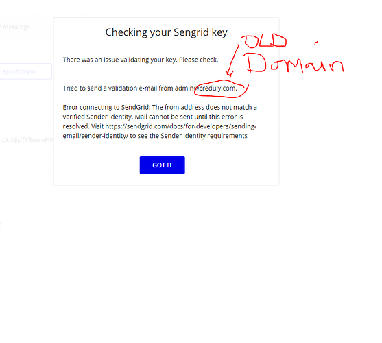

Hello, not the affordability, I just didn’t want to spend that amount for a quick fix. The account was verified on send-grid, but on bubble the side I still get that error when inputting the API key. I noticed that the error was giving me a old domain that is not the new domain that has been connected to the app. Could that be a reason, maybe a caching issue with Bubble?
I’m thinking maybe something with Bubble, yeah. If there is no way to change it, then maybe send Bubble a bug report. If it’s the old domain and there is no way to refresh it, maybe they have a way to fix it. I would contact Bubble, for sure, to see if they can help with it. :+1:
