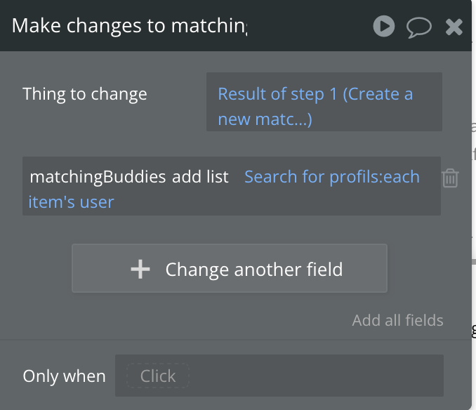

I did it but it seems it does not work :frowning:
In bubble:
In SendGrid:

So the email being sent is empty? Do you want to debug this on a quick call?
Try three curly braces: {{{ }}}
